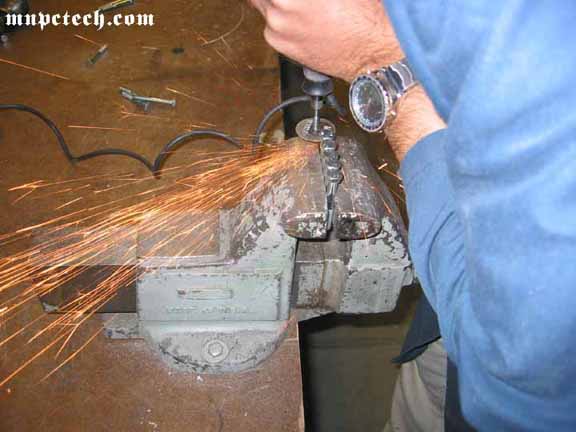

and as for the two hook vs single in the reciver, i got a solution for that delemia too. if i can chop a mosin barrel with a sawzall, i think i can handle a slot in a reciever

Or you could just lop off a hook

AgAuTHORITY wrote:Or you could just lop off a hook
Ag
logical and sound solution. question is, which way let's me grind more metal? :P
