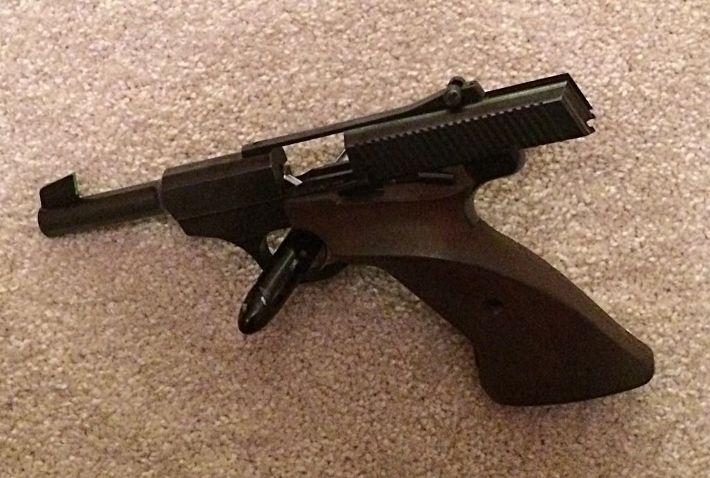

Hey folks,
I just picked up a surplus IMI Jericho 941. I really quite happy with it considering it was a internet purchase and wasn't sure exactly what I would be getting.
That being said. I would like to get the finished reblued.
I have done some research on dyi rebluing, specifically the hot salt method. It doesn't seem to be too tough. Has anyone tried it? Any horror stories?
The other option of course is to take it in. Would anyone have any recommendations on a local metro area shop to reblue it for me?

Here is the gun BTW. Still dirty as sin but not bad for $239 shipped!
http://imgur.com/a/91Lng
