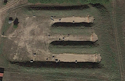

Postby xd ED on Sun Mar 04, 2018 11:30 am
Can you use existing soil for the impact berm?
Could you grade the shooting lane(s), or grade/ trench the area beyond the impact berm lower and use the soils for berms?
..lowering an area of 100' x 100' a depth of 2' displaces 750 cubic yards of soil...
...that could create a peaked berm 89' long x 15' high, with 1:1 slope; you could make it longer, or higher with the same volume of matl. if you have ballast- (logs, old ties, tires?) for a base/ toe of the berm.
Might not be the ideal spec for an impact berm, but its a lot more protection than some shoot at
...lowering a 100' foot shooting lane 2' would create a 14' peaked bear per linear ft of berm/ shooting lane
....a 150' lane, lowered 2' creates a 17' peaked berm per linear ft of berm/ shooting lane.
Beaverbrook did this with sandy soils; (I don't think they brought any in...)
BeaverBrook Pistol Range.png (274.76 KB) Viewed 14473 times
