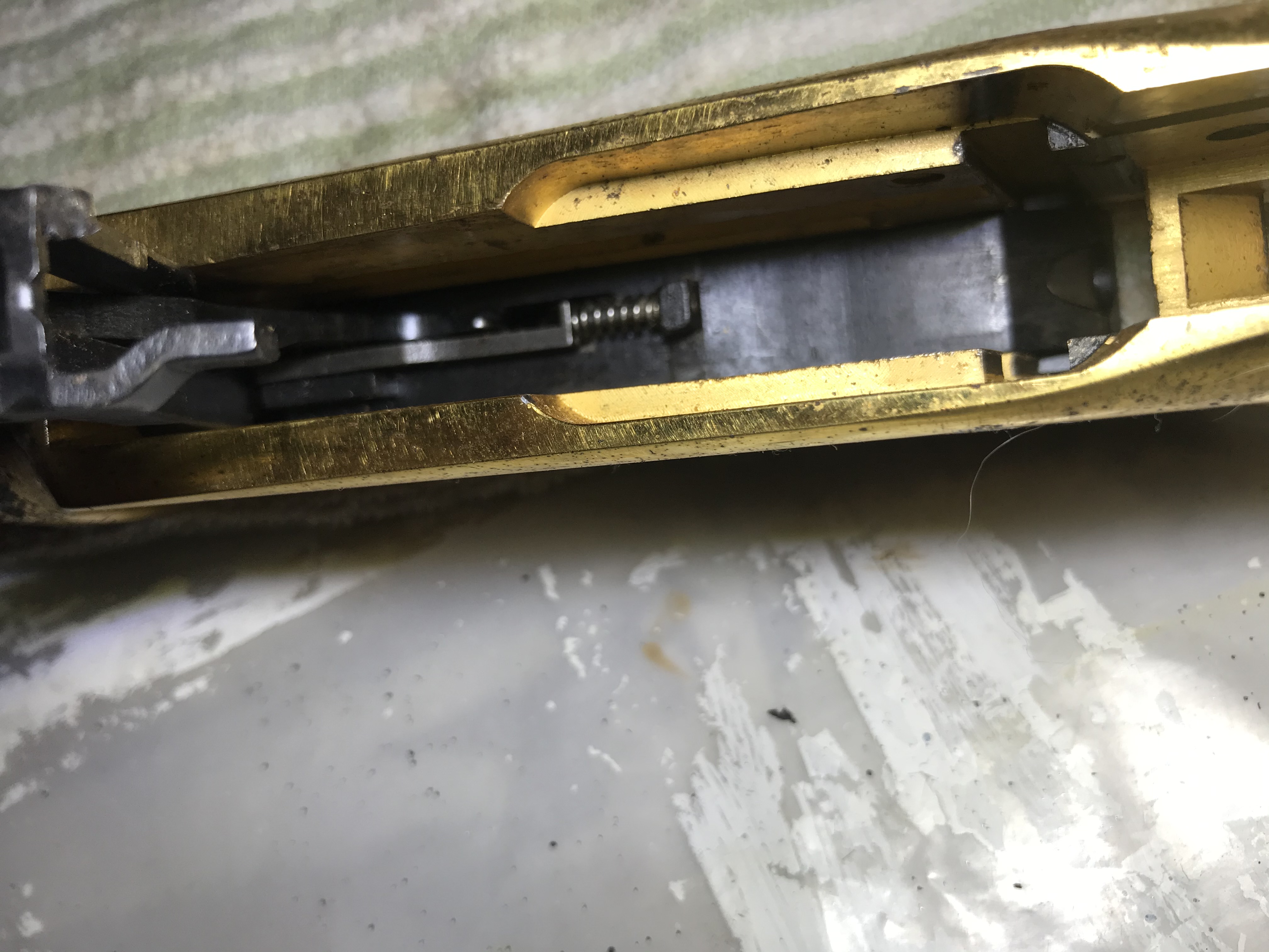

Here's what I meant by the bolt/lever release.....the lever (lever action) connects to the bolt somehow, probably a pin, or some kind of detent. The lever -according to the schematics- just hooks into that pin on the bolt. I can't see how to push out that pin (assuming there is one). I've uploaded a pic of the bottom view of the lever going up into the bolt.

Postby 870TC on Fri Apr 03, 2020 9:35 am
Finger lever pin needs to be removed. If you look at the link I provided theres pictures showing how to disassembly that. counting pics from top down start looking at the 11th pic. heres the link again...

Postby Bergie on Sat Apr 04, 2020 7:38 am
870TC wrote:Finger lever pin needs to be removed. If you look at the link I provided theres pictures showing how to disassembly that. counting pics from top down start looking at the 11th pic. heres the link again...
http://www.castbullet.com/misc/tdown.htm
Sorry, my bad- that's it!
I should have photo-journaled these projects. I gave the 870 barrel and receiver a bath in Brownells rust dissolver and it took her right down to bare steel! So now I'm a little gun-shy of doing the same to the Centennial. I don't want to strip the gold off the receiver. I might try applying a few drops on the inside of the receiver and let it sit overnight to see how it affects the gold coat.
