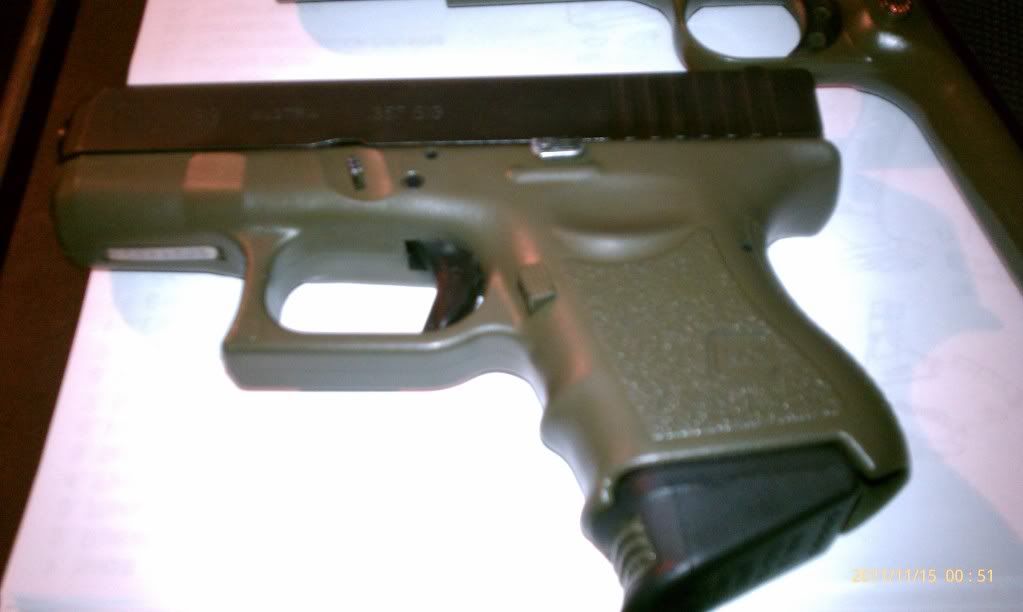

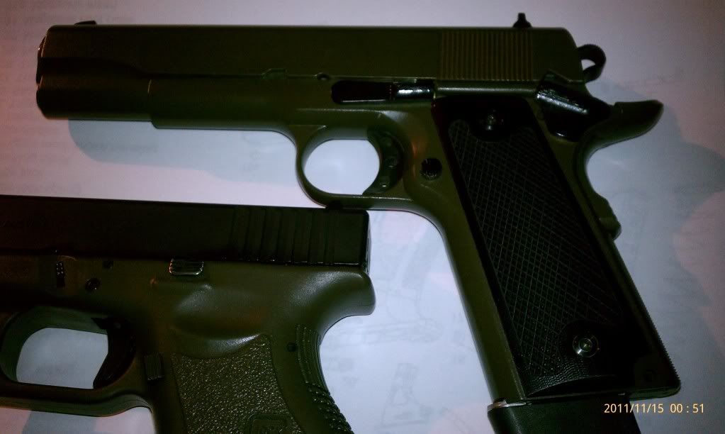

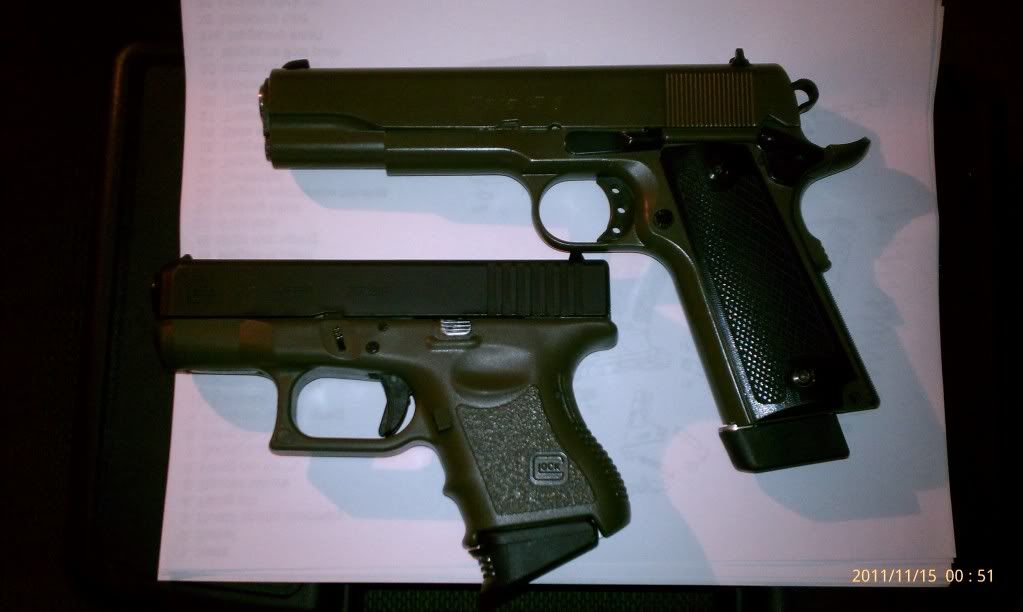

Postby mccandmatt on Sat Nov 12, 2011 1:25 am
I just last week ordered the Duracoat Shake n Spray and I have to say I am pleased. I did my 1911 and screwed up the first round, sprayed on a bit to much and got some dribbles. Easy fix, 800 grit sand paper on the area with the runs and put a coat or two over it and it blends in perfectly. If you totally screw the pooch just rough up the finish some and reapply, or change colors. The arosol sprayer did leave a texture on the 1911 but I actually like it, however when I did my glock frame is went with really light coats and I sprayed it from a further distance and that seemed to eliminate the texture. I reassembled my 1911 about 8 hours later with no issues. I reassembled the glock after 2 hours and even holstered in my blackhawk holster and carried it for 12 hours without a single scratch.

Postby mccandmatt on Tue Nov 15, 2011 12:49 am
Hammer99... wrote:
mccandmatt wrote:I just last week ordered the Duracoat Shake n Spray and I have to say I am pleased. I did my 1911....
Pics please!
I forgot the pics, Ill take now and post
Pic:
G33 Was all black, but duracoated the frame
Para 1911 was all black but stripped it to the stainless and duracoated
