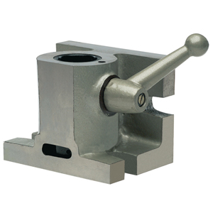

Very nice indeed. That is now on my list of things to accomplish someday. I agree aluminum would be a good way to go but not necessary, also I think you could make this work with a 5c collet fixture if you had one laying around but you would not get all the versatility as the ball joint.
