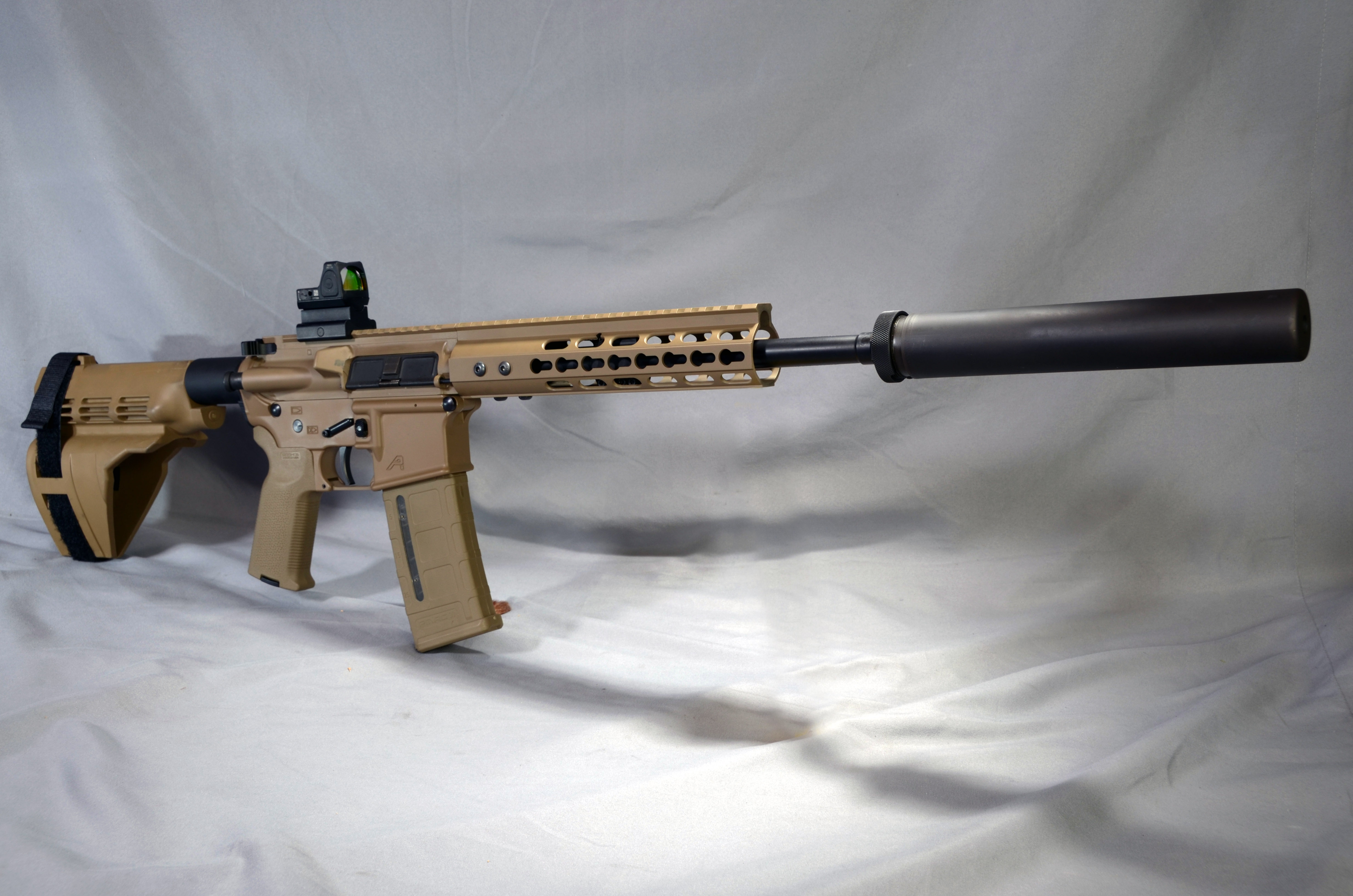

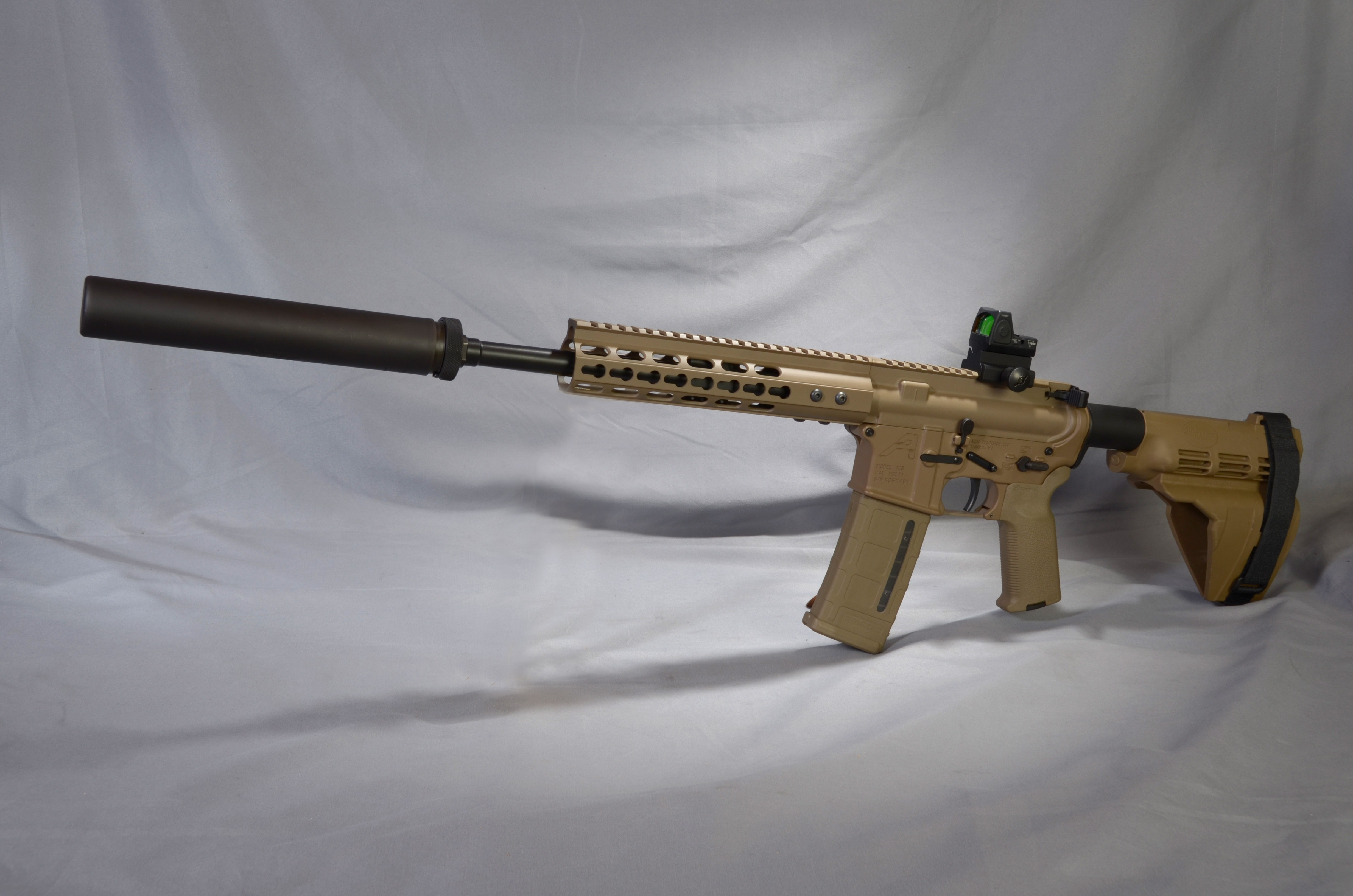

Yes. This AR Pistol uses an adjustable gas block on a 10.5 inch barrel. The 300 BLK is remarkably quiet using subsonic ammunition. The predominant sounds are the cycling of the action and the loud "DING" of the round hitting a steel target. The first time people shoot it they usually have a big grin on their face.
300 BLK Pistol RH
300 BLK pistol LH
The subsonic rounds don't shoot flat for very long so there's no need for a high power scope. If the RMR is sighted in at 50 yds. The holdover will be 8 inches at 100 yds and 50 inches at 200 yds. No long range shooting...
