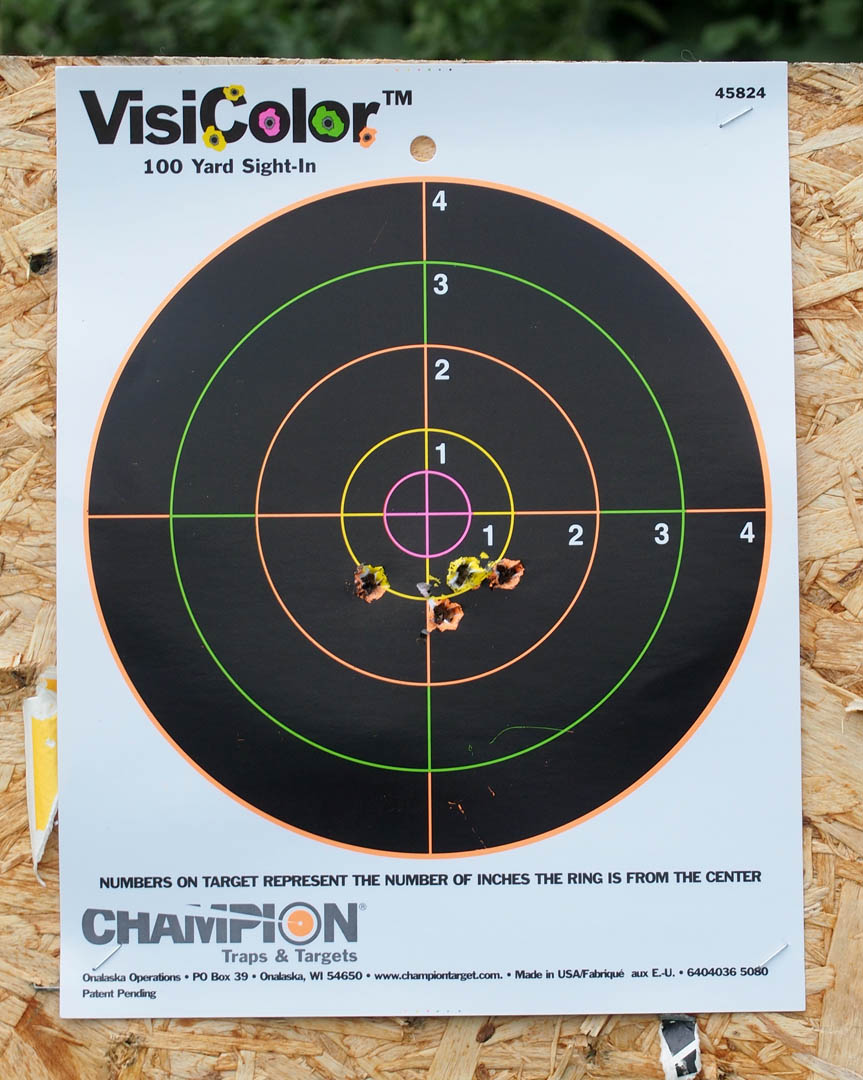

Postby warrlac on Thu Jul 07, 2022 3:35 pm
Follow-up post:
The wind died down today and I took more care in consistently securing the DD Wave QD to the mount. Summary -- I am satisfied with the suppressor for the moment. When installed with a firm, bottom-out and locked connection the can is holding zero. Below is a 4-shot 200 yd group. The gun is holding around 1 MOA in my opinion. (The last shot on the left was one that I could feel was not quite crisp)
I like shooting with a suppressor simply for the avoidance of having to wear hearing protection. The supersonic crack is still substantial, but in my opinion tolerable.
When some of the other board members get their cans out I'd be interested in knowing what their experiences with mounting and removal yields...
July 7 2022 200 yd 4-shot group 6.5 Creedmoor
