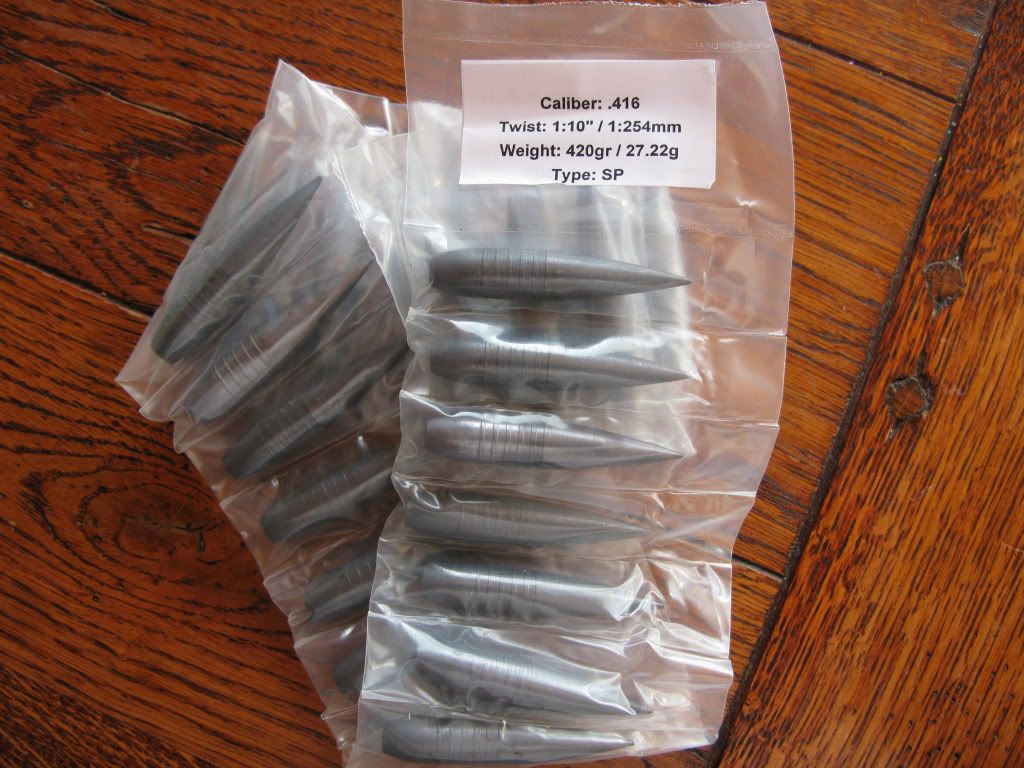

It’s just a dream at this point, I’m pretty happy with the availability of the SMK’s and I’m just starting to play with the new Bergers, but someday it would be fun, be nice if they made it a hybrid like the new Bergers, those Secant Ogive bullets can be tricky to find and maintain a perfect seating depth.
I've been spending some time at the GS Custom Bullet web page that Ragged has been talking about. I don't know if this is an honest representation of the bullet he's talking about but WOW!
I couldn’t find pics of the 338 pill but here are some 416’s (not as good of a BC)
I like the pack job!
Check out the 1100gr 50cal bullets, insane!
