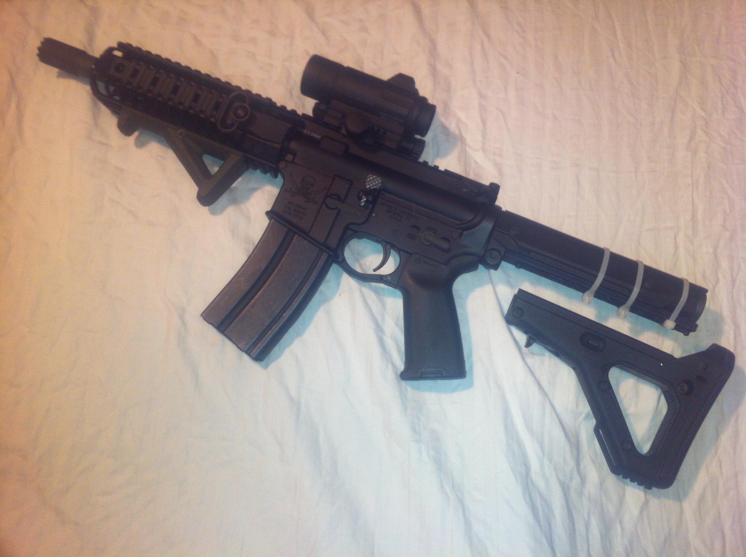

I have 2 5.45 ARs and love them. Ammo is cheap, especially since I stocked up on 10k rounds when it was going for $130 per 1080 rd. can. I liked my first one, which was built as a cheap beater rifle, so much I built a 8.25" that is awaiting a tax stamp. Pmags work if you download them, but not as well as dedicated 5.45 mags. the problem is that the lower case neck causes rounds to nose down and jam against the front of the mags. In 30 round pmags I didn't have problems when loading 10, but had occasional problems when loading up to 25. Bad news loading more than that. I advise to only use pmags in a pinch and stock up on 5.45 mags when you can.
Here is the shorty. I just posted this in the gun pic thread.
