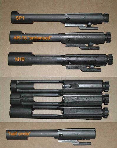

As for the bolt carrier group (BCG) look for one that is a full auto vs semi auto design. You can see the rear of the bolt (top left of stolen picture) will have uneven top and bottom halves on the semi auto, where the full auto (M16) will be even top and bottom. You also want a fully shrouded firing pin. In the center picture the top bolt has an exposed firing pin while the other two fully shroud the pin. This protects the firing pin from the hammer when the bolt cycles. You want a properly staked gas key (google it for examples), and if possible the BCG is high pressure tested (HPT) and magnetically particle inspected (MPI). If I think of anything else I'll post it up.
