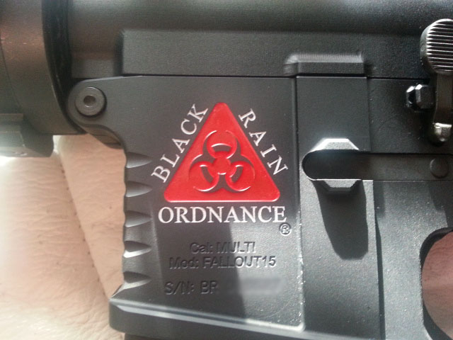

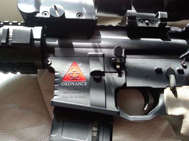

Black Rain billet lower with color fill
Postby madFatter on Sun Jul 21, 2013 3:15 pm
Bought a BR lower and was on the fence about color fill. Tried searching the web for examples but could only find 1 picture in yellow. Decided to go for it and see if I like it. Wife and I are happy with the outcome. Figured I would share it for the next intrepid web explorer to find.

Postby mahnster on Sun Jul 21, 2013 3:22 pm
Looks good. What process did you use?
mahnster
Posts: 103 [View]
Re: Black Rain billet lower with color fill
Postby madFatter on Sun Jul 21, 2013 3:31 pm
Testors enamel, thinned down. Applied with an insulin syringe. Worked pretty slick, fast and no clean up.

Postby madFatter on Sun Jul 21, 2013 10:52 pm
Thank you for the compliments! I'll admit, there were a few "OH S#!@" moments before I switched tactics and went to the syringe. With the right tools, it's an easy job. Buying the syringes was somewhat entertaining also.
me: I need the smallest syringes you have.
pharmacist: (unamused stare) If you're scared of needles, I think you need a new hobby.
m: No, no. I'm going to use them the fill the engravings on a rifle with paint.
p: (dumbfounded stare) You are going to PAINT... a GUN... with a NEEDLE? I do not have time for this #@$% today.
But then she got me their smallest syringes. 31ga .5in 1CC insulin syringes FYI. 10 pack for $3.50. Worked great for the small stuff, had a tendency to bend a little and flick paint on the bigger area.

Postby Synergy on Tue Jul 23, 2013 3:25 pm
Looks really good, did you paint the red right on or did you lay a coat of white down first then red?
Synergy
Posts: 287 [View]
Joined: Sun Jan 13, 2013 9:39 am
Postby madFatter on Tue Jul 23, 2013 3:54 pm
That's just red, I didn't want the extra brightness.
