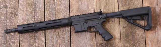

JP GMR13 uses Glock mags. It's what I'd like to own.

The JP GMR sure looks nice, but I don't know about $1500 nice, and their stripped glock mag lower is $400! A complete RR is $1200 and stripped lowers are still $300. The JR carbine seems to have iffy mixed reviews and doesn't share many parts with AR's.
I just don't get why 9mm carbines cost so much. The HiPoint cost $189 and there's not much engineering involved, so it shouldn't cost $1000+ to make an AR run 9mm, esspecially with the glut of AR parts out there. The only proprietary parts are the barrel and blowback bolt, and some way of attaching a mag.
