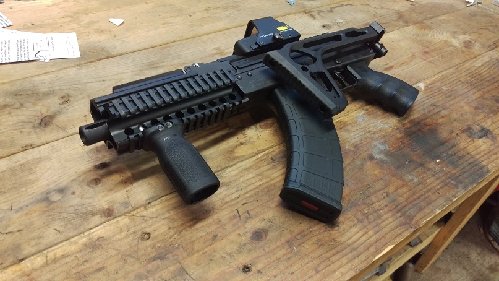

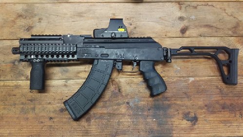

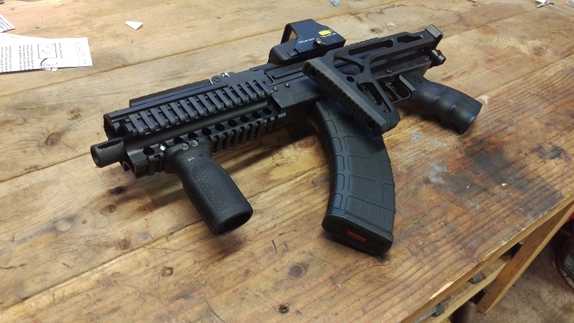

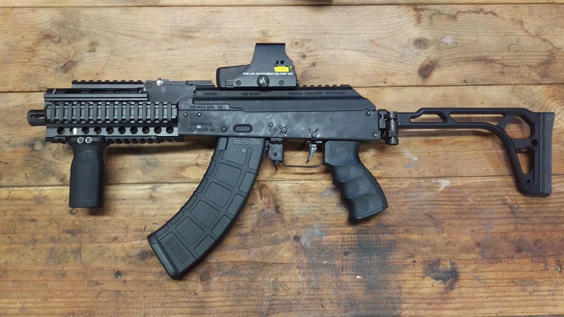

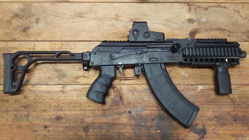

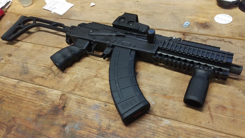

Took about 3 months give or take. Used a trust from 199 trust (recommend) and e-filed. Filed for a Mini-Draco pistol and an Atomic M-15 (AR-15) receiver. Haven't touched the AR yet, as that will be a expensive machine (piston 10.5in). But the AK is done, just had to order the stock.
Specs:
2014 Mini Draco Pistol
Receiver is fitted with a 1.5 in 4 slot picatinny rail that is fixed by a single bolt and also bonded to the receiver with 3m Bonding epoxy (hardcore stuff).
Stock is a Sig Sauer MCX/MPX light folder. It fits beautifully on the rail and folds like it was designed for this gun. I love how it came out.
Front rail system is a heavily modified UTG M70 Yugo rail. It utilizes the factory "hotdog bun" mounting point as well as the barrel/gastube clamp. The front sight was cut off and reshaped to clear the rail.
Rear cover is a TExas weapons systems railed dust cover. It has a Chinese knock-off trigicon sight. It is too big (wide) and I feel like I'm probably going to change it. I have a Sightmark on my Mini-14 that I really like, I may get another for this thing (the one on my Mini has a laser and will not fit).
For 922r compliance it has a ALG AKT trigger kit. The trigger pull is fantastic compared to stock, but the trigger group does not work properly with the Draco bolt carrier. I am going to contact ALG about a solution before I machine off any metal. The bolt carrier contacts the right side of the the trigger sear. Comparing it to the original draco one, it has a relief cut to clear the bolt carrier.
Rear grip is some thing I got off Amazon a ways back, I do not remember what it is. The front grip is a Magpul MOE. I would have preferred it an inch or so back, but it would interfere with the magazine.
I plan to cerekote it. Might just do a solid black. But I am considering Burnt Bronze, Crimson, possibly a dark blue color. The AR is white.
Need to sort the trigger before I go shoot it. Maybe this week. I'll post up a range report first thing.

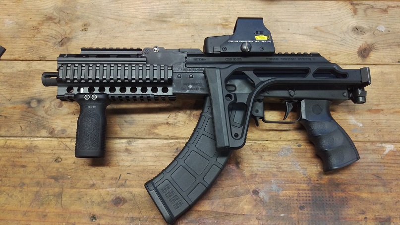

Engraved! Taking it out on Thursday.
Some better pictures, all cleaned up. And some shots of it with an AFG and the rear mount.

Postby Machine on Sat Sep 24, 2016 9:40 am
This thing is more or less finished. Time to move on to the Ar-15 SBR build.
First time using duracoat. Used the Aerosol kit in Combat Gray and I'm very happy with how it turned.
Stripped the receiver of whatever black gunk it was coated with, came off with little effort. Wire wheeled some tricky spots and sanded everything with 380 grit. Anodized parts were scuffed with 600grit. Cleaned everything with generous amounts of 3m Brake cleaner and then wiped everything down with automotive paint prep. Hung in the garage and Sprayed.
The can-in-can aerosol worked very well and sprayed smooth. It comes with an extra spray button which was nice as it clogged mid second coat. Everything got 3 coat, top part of rail ended up getting 5 as it had some wierd spots that were hard to get.
I let it hang for two days and then sit for 1 week before reassembly. Got back together with no scratches but I'm going to wait a month before I take it out to the range.
Overall I'm very happy for a total cost of about $60 (including all the brake cleaner I bought)
