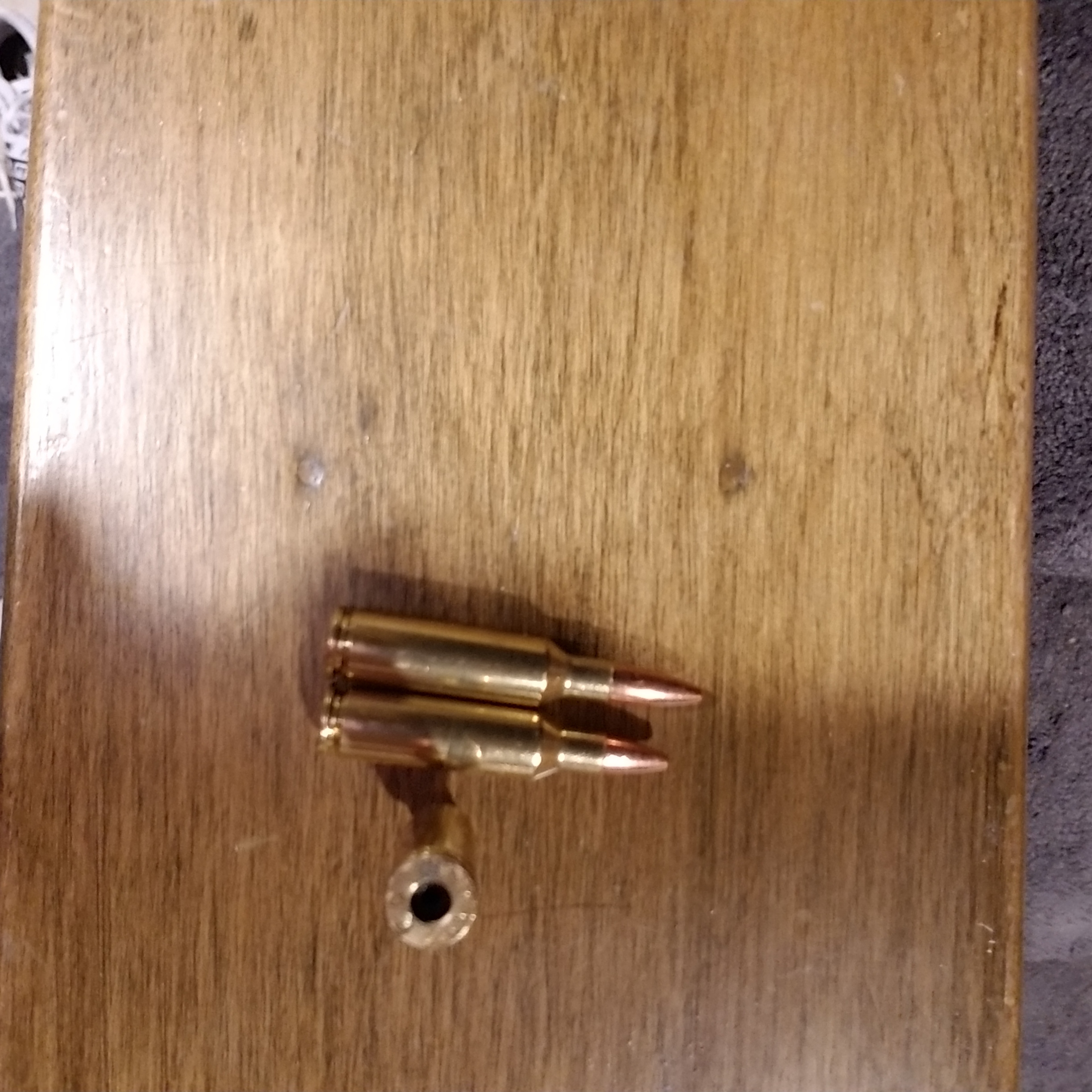

What the crap mag was did to 3 rounds caught the 3rd.

Amazi wrote:What the crap mag was did to 3 rounds caught the 3rd.
Not sure what you are asking

didn't ask a question.... just showing what junk mags do is all. First time I've ever seen a primer blowout, and a mag do that to the bullet on feeding.

Amazi wrote:didn't ask a question.... just showing what junk mags do is all. First time I've ever seen a primer blowout, and a mag do that to the bullet on feeding.
Primers typically blow out under high pressure conditions, either a tight chamber or higher powder charge (or a combination of both). Unless the neck tension on the case is very low, you shouldn't get bullet setback like you're showing. I don't know that a mag would cause either of those conditions.
