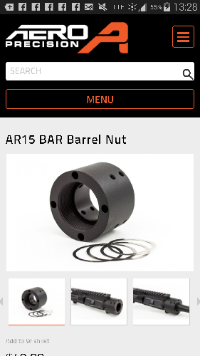

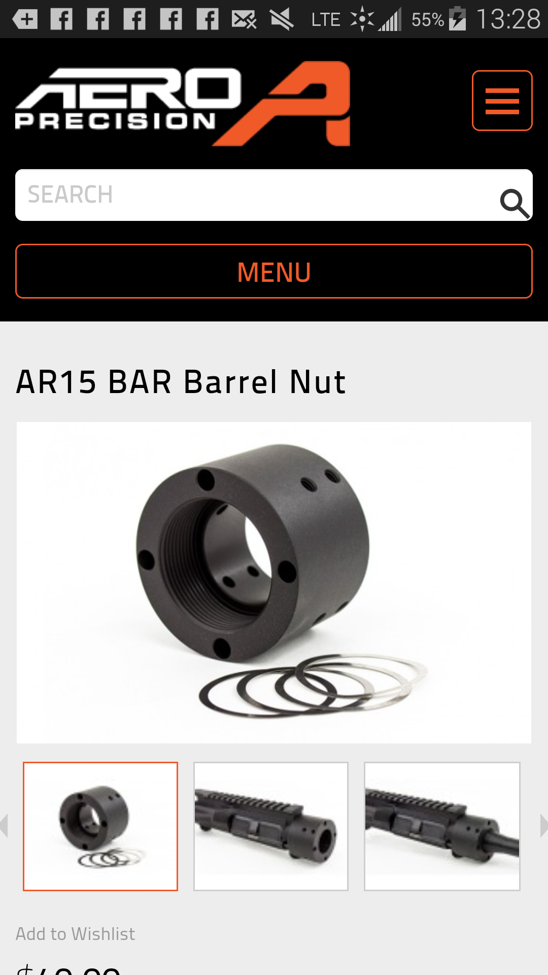

Postby mc762x54R on Sat Mar 31, 2018 12:28 pm
This is what the nut looks like
mc762x54R
Posts: 298 [View]

Re: AR15 barrel nut shims?
Postby Ghost on Sat Mar 31, 2018 2:01 pm
mc762x54R wrote:This is what the nut looks like
That’s a hell of a nut. How much have you torqued it and how far off is it?
I’ve gone up to 85 ft-lbs before on an AR. 30-80 is the spec range, no idea what your instructions say though.

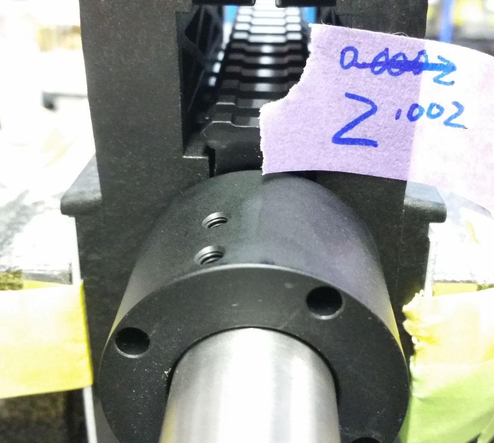

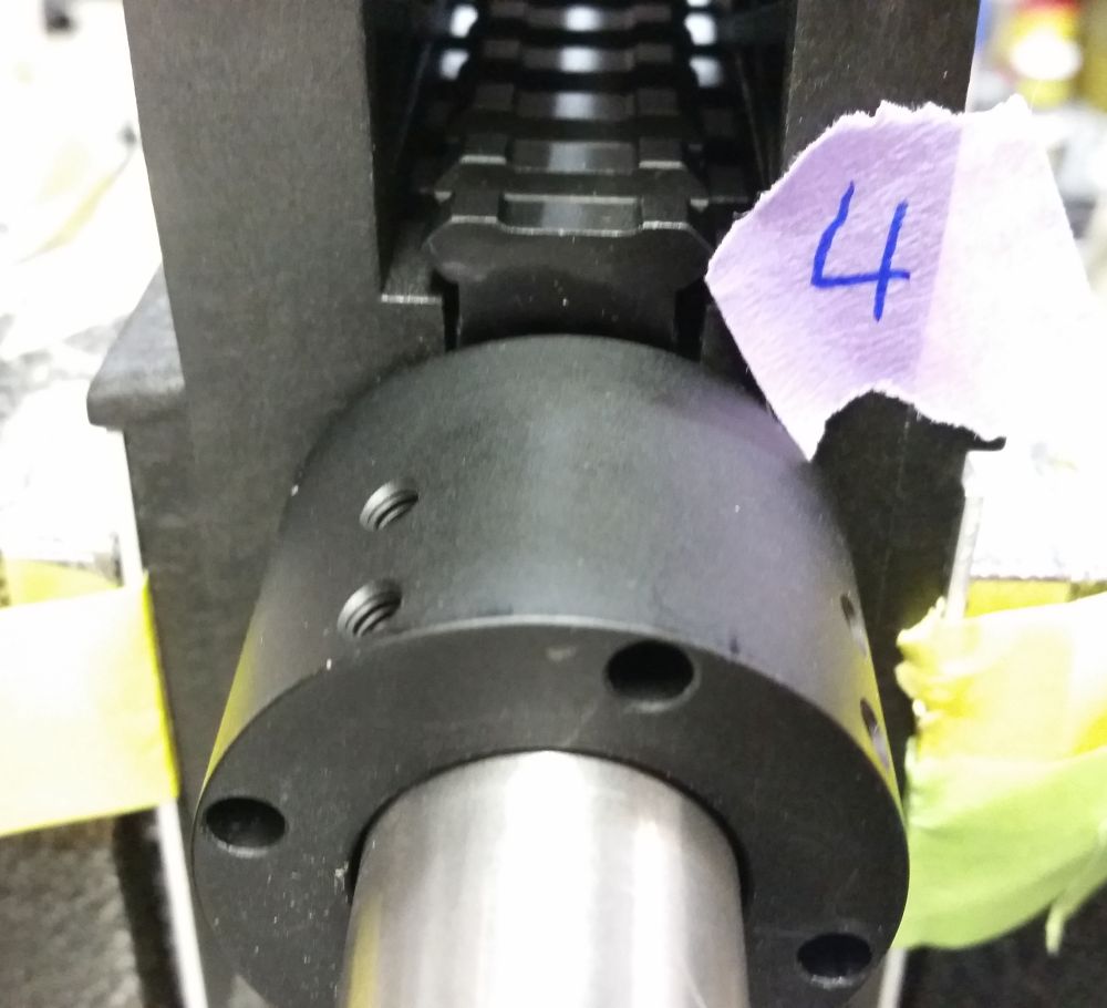

Postby mc762x54R on Sat Mar 31, 2018 4:04 pm
Here's the difference between 0.002 and 0.004" of shims
mc762x54R
