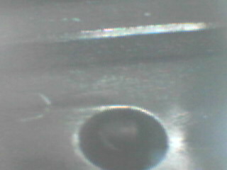

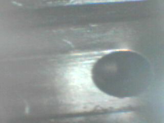

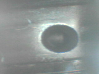

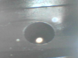

Postby Bearcatrp on Wed May 22, 2024 6:51 am
Its a areo precision adjustable gas block. According to the little flyer, turn clockwise until it stops to fully close it. Haven't touched it so not sure where setting is now but will close it, then back off 10 clicks to start, then keep backing off until bolt locks back. But, will get out my bore scope first to see if its lined up properly. Plan on shining a light into the tube hoping I see light.
Can't tell by these pics
