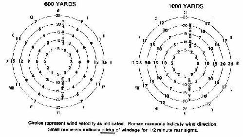

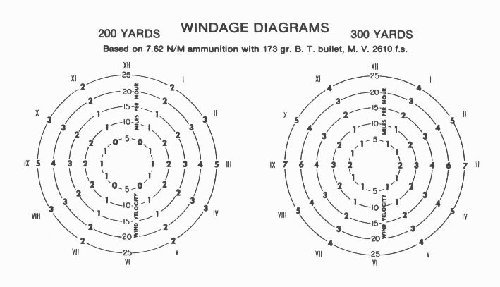

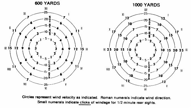

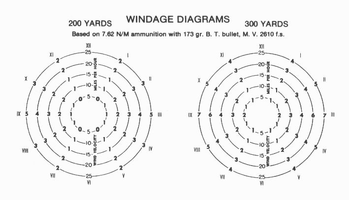

If anyone's interested, I found these on my hard drive from years ago when I use to shoot 30 cal.
The numbers at 6 & 12 o:clock are wind speed, the other numbers in the circle are windage corrections in 1/2 minute clicks and the Roman numerals on the outside are wind direction.
600yds & 1000yds
200 & 300
Posts: 4246 [View]
Re: Reading the wind.
Postby farmerj on Mon Mar 22, 2010 6:43 pm
Those will work for more than just the .30 cal too.
the M855 and M80 ball ammo have very similar ballistics and as such, the come-ups and wind holds are very close and similar.
One of the nice things of using surplus ball for practicing. 5.56 is cheap compared to 7.62.
