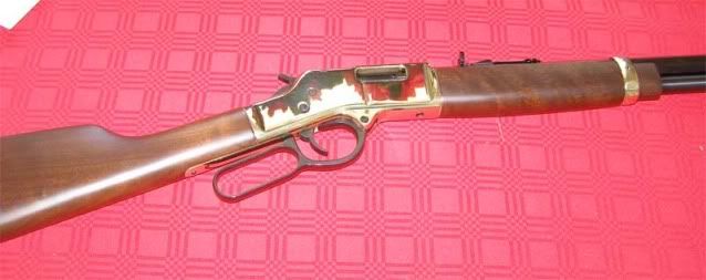

Postby rikkor on Mon Dec 20, 2010 12:27 pm
I just put on lay-away until next week a Henry .44 Magnum "Big Boy." Do any of you guys have a recommended break-in procedure, or is none necessary? I appreciate any help you have to offer.

The response from Henry was that no break-in was required, just shoot it. I did run a couple of patches through it before I shot it. What a nice rifle!
