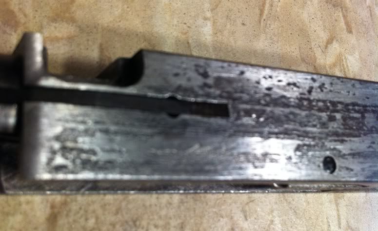

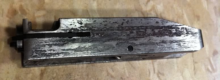

The action was not all that smooth as I was workin' it so I figured I would break the rifle down, pull out the Dremel and try to work some magic with a wire wheel/polish wheel etc.
I pulled out the bolt and saw this.
Looks OK for a hundred dollar .22. the side you always see.
WHAT???!!! what is this cr@p? I won't see this except when I take it apart, but REALLY?
I got the rifle at Fleet Farm, because I love that place, the lady at the gun counter opened the box in front of me, asked if I wanted to inspect it.. I had already decided I was buying the $99 Marlin 795. So I just looked it over and said "Yep that's what I want."

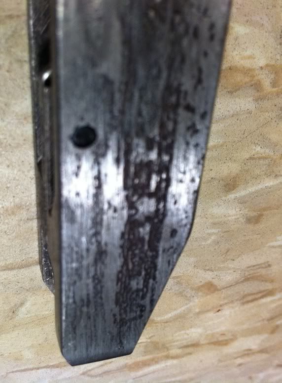

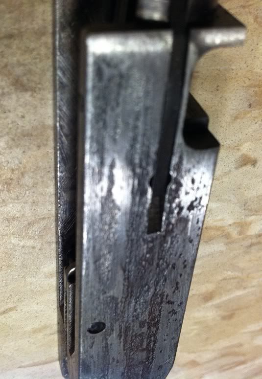

Man, I am bummed. The receiver side of this bolt looks all pitted and nasty. I don't know if the Pics will show what it really looks like. but to me it looks like a brake rotor of a car that gets driven through salt water twice a year, and then sits until the next trip through seawater. PITTED

220'wet or dry paper and a flat piece of glass wet the paper and stick it to the glass and flat sand the side of the bolt.
If FF is selling the gun for $99 theyre buying it for $79delivered which means Marlin is making the gun for about $39 to make Anything on it when they sell it to Hicks or RSR, so getting a highly polished anything at that price is pretty good so add a few minutes of your own labor and finish the job

I agree with this. I'd add that you shouldn't make it your goal to remove as much material as it would take to smooth out the piece and eliminate all evidence of the pitting. Clean it up to make yourself feel better and shoot the heck out of it. Shoot it today and don't worry about it. Clean it up when you get time later.

Flat sand or stone the burrs off the one side enough for the action to run more smoothly and be done with it. Just dont take a lot of meat.
Two things come to mind....
1. its a NIB $99 rifle. As such fit and finish is low on the list of priorities.
2. The side that is ugly is never going to be seen when the gun is assembled, so if you don't tell anyone, they will never know.
My guess is that if you take it to the range and run a brick of .22 through it, it will be running like a champ in no time.
Oh yeah, and put down the dremel........ that will just make it worse.

I've got one of these 100 dollar marlins too, and while mine wasn't quite that nasty, it was pretty bad in its own right. Sand it some with a flat (glass trick etc), and shoot the piss out of it. It'll be fine.

Putting it on the belt sander will put it out of spec. If the firearm works, try not to worry about what you can't see. There are many guns with rough castings and machining out of sight.
