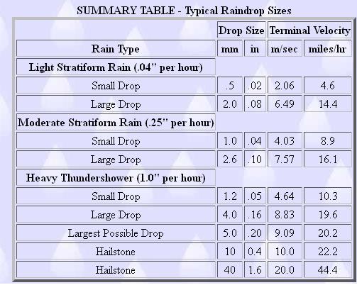

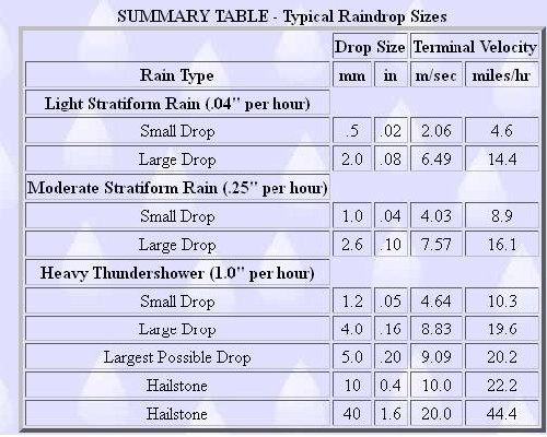

Check it out 7.57 m/sec compared to a 3000 fps bullet (914 m/sec). The raindrops would essentually be frozen in place during the bullets flight, so it would most likely be a funcion of rain density over the caliber diameter and distance. So probably pretty light since all you guys wouldn't be shooting in a torrential downpour... :D
