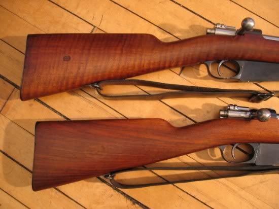

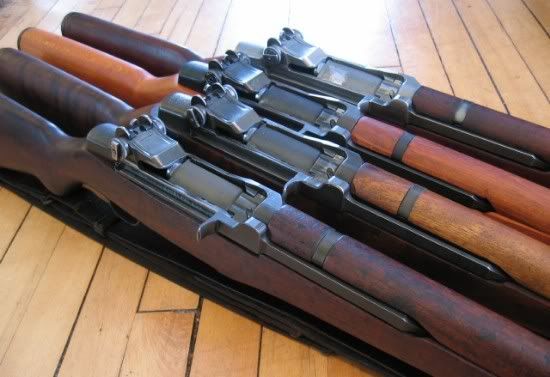

GregM wrote:I have tried my hand at restoring several of these old soldiers.
