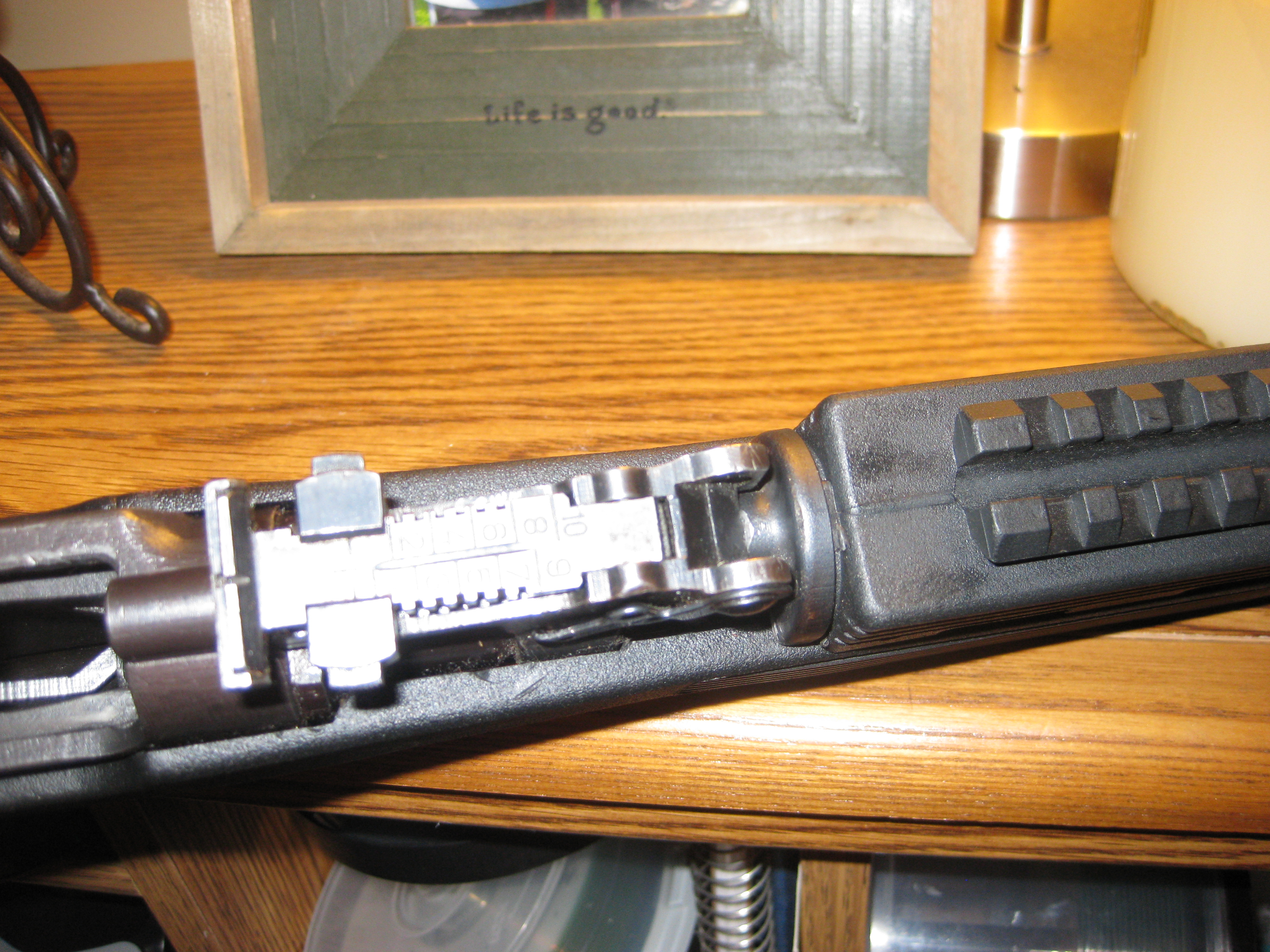

So I received a SKS from my uncle for a graduation present and there was a crack in the stock we noticed so we got a Tapco stock and being new to modifying guns went to youtube for advice and the guy on there said to file metal part at the back of the gas chamber. ( the piece that the little pin goes through) to make the new tapco part fit better. This didn't work and then we saw plastic is a lot easier to file which did work.
Here is the problem. When I shoot now the Piston flips up and the gas chamber doesn't stay seated great. I would love to fix this by getting a new metal part for the end of the gas chamber but I can't find anywhere to buy it. If anyone knows of a place that has it in stock I would greatly appreciate any help or advice I could get.
Also Last hunting season I was in my sitting in my tree stand and rested the butt of the gun on the foot platform, the gun went off about 4 inches in front of my face. I have cleaned it extensively since then but is there any way to make sure the weapon is safe to handle? Again any help would be appreciated. Thank you.

Can you post pics of the parts you modified? SKS's are pretty simple guns and we should be able to get you up and running.
As to firing when you set it down, that sounds like more of a concern. Make sure the firing pin channel is clear of any grease and debris. Dissassemble the bolt completely to clean it properly. You can't do it right without removing the firing pin.
Make sure the trigger group is also free from grease. I really don't like dissambling those and you can hose it out completely with brake cleaner or other solvents, blow it out with an air compressor if you wish, and then re-lube with your favorite gun oil.
Once clean, make sure the rifle is clear and run through the safety checks - does it fire when the trigger is pulled? Does it not fire when the safety is on? When the safety is then moved to fire, does it then fire? If you hold the trigger back, does the hammer get caught or follow the bolt home? Things like that. If that's all good, try to induce a failure by hitting the buttstock on the ground and so on.
Only once you have done all the above, take it to the range, load 1 round with it pointing down range, and see what happens. Then load and fire 2 rounds. Do that a few times. Then run through the safety checks again (keeping it pointing down range at all times) and see what happens with it loaded with a single round. Don't try to induce a failure by hitting the stock of a loaded rifle, though. That's asking for an accident.

I appreciate all the advice guys. I was hoping that I would be able to be a little more handy with firearms but I yeah I think that you guys are right about looking into a gunsmith. I included a pic of the part of the SKS that I filed trying to get it to fit. Thanks for your help guys.

Get another picture or two. Open them in Paint or another rudimentary photo editing program and draw some lines and circles showing exactly what you filed on. If you filed on the latch on the gun, you're probably SOL. If you filed on the gas tube itself, you should be able to replace that for just a few dollars at a gun show or order one online. But I think we still need more info on what you did.

Sounds like negative engagement of the trigger. Also, have you removed the firing pin from the bolt to make sure it's clean?

You're not the first person with the Gas Tube issue thanks to the Tapco stock "upgrade" which includes a replacement gas tube that's often out of spec:
http://www.gunandgame.com/forums/sks/47 ... oblem.html
http://www.thehighroad.org/archive/inde ... 03696.html
http://www.calguns.net/calgunforum/show ... p?t=483348
Seriously, rip that crappy Tapco stock set off and put the original wood and gas-tube back on the gun. Hopefully you didn't remove enough metal from the receiver trying to fit the Tapco gas tube unit that it's beyond repair, if the rifle doesn't function properly with the original gas tube (with the wooden top handguard attached) installed you are pretty much screwed ...
The more troubling aspect of this is the unintentional/negligent discharge... The SKS has a very obvious safety mounted on the trigger guard, was this engaged (flipped "up") when the gun fired in your tree stand? Did you simply bump the rifle against the base of your stand when it discharged? It could be a number of problems including a stuck firing pin (rusted/bent so the pin protrudes from the bolt, if this is the case you are lucky you did not get 10 rounds in the face when you dropped the bolt into battery), prior trigger modifications by a previous owner, etc... If you are going to own and operate a surplus gun like this you HAVE to understand how to completely strip and clean it, including tearing the bolt apart to remove the firing pin, extractor, etc... Most of these were soaked with cosmoline (a thick, jelly like preservative grease) that has to be removed from nooks and crannys to operate safely - simply blasting some bore cleaner into the bolt and trigger mechanism is not going to cut it. The Yugoslavian models (with the funny flip-up grenade launcher sights) are notorious for firing pin/internal rust problems that can make them unsafe without proper cleaning and maintenance before shooting them for the first time and are very common in the current marketplace.
There are a TON of resources available on how to completely disassemble and service the SKS rifle, Google is your friend, they are one of the easier milsurp rifles to break down and completely clean in my experience if you are willing to spend the time. A new wooden stock for the rifle is only $25 (http://tickbitesupply.com/sksstk.html) and would probably be a better direction than continuing to fool with the Tapco aftermarket upgrades. The SKS is well designed and reliable in it's original form when properly cleaned and maintained, there's pretty much no functional improvement in the weapon that comes from adding anything Tapco to the gun but a large risk of making it less reliable.

Madmartigan wrote:I have not taken apart the firing pin yet but everything else, I wasn't sure if I would be able to get it back together but I will be looking into that as well. I have a mac so I will look into seeing what I can edit photos with. I just got it and haven't played with it too much. But I will post more pictures for sure. Thank you
Take apart the bolt and get it cleaned. There's nothing difficult or magic about it. You just need a hammer and punch. There are lots of online resources for this if you are nervous but it's really pretty easy. Cleaning around the firing pin is very important with surplus SKS's. After you do it once, unless you shoot a lot or shoot corrosive ammo, you may not have to do it again. Just make sure the firing pin channel is clean.
