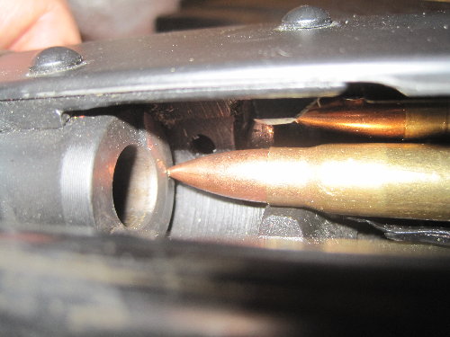

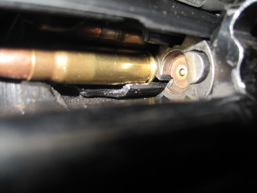

recently picked up an Ak pistol. got a problem with it jamming though. does it constantly. seems that the rounds are not being "lifted" enough (?) and they're slamming straight in to the barrel extension (i think that's what it's called). anyways, here are some pics of the issue:
usually slamms the bullet back in to tha case and ruins the cartridge. dents up the ball ammo in either case.
apparently my google fu is a little weak, all i found was some dudes who said to hog off a feed ramp with a dremmel :shock:
anyone run into this? i'm none too familiar with the commie guns.

First I'd try a few different mags, including a polymer one if you can. Also check to make sure bolt guide rails are even and the welds are intact. The carrier should move easily with no binding, and bad rails will push it off to one side or downwards, causing a FTF.

Looks like your having the same problem but with FMJ's? Possible that the mag isn't going up all the way...? maybe hitting on the lower rails if they were installed too low. I'd think you'd know that though if the bolt carrier slides good and ins't too low. Do you have another you can compare it to?

You need a "bullet guide". Use a piece sectioned off a steel pipe and either have it welded in or countersunk screwed into the front trunnion.

tsk tsk shippy... shoulda held onto the 74 you sold me! it has none of those problems... but seriously, from the pictures you posted, it looks like the feed that's there, is bent.

Notice how low the feed lip is compared to the cutout in the bolt? Looks like the magazine should be a 1/8" higher or so. I'd recheck the mag catch to see if it's the correct height, if after adjusting it it still doesn't feed I'd add the M4 style feedramp cuts.

Looks like it is missing a bullet guide, looks a lot like a saiga from what i can see, looks like it may even have the hole already drilled for the guide. You can get those from carolina shooting supply, tromex saiga might have one or be able to get one as well. Who makes this ak? Any pics of the inside without ammo in it? It was nice to meet you also (walgreens lot).

Hmmm... I will say something doesn't look quite right in your pics... Could be the bullet guide thing, as mentioned.
