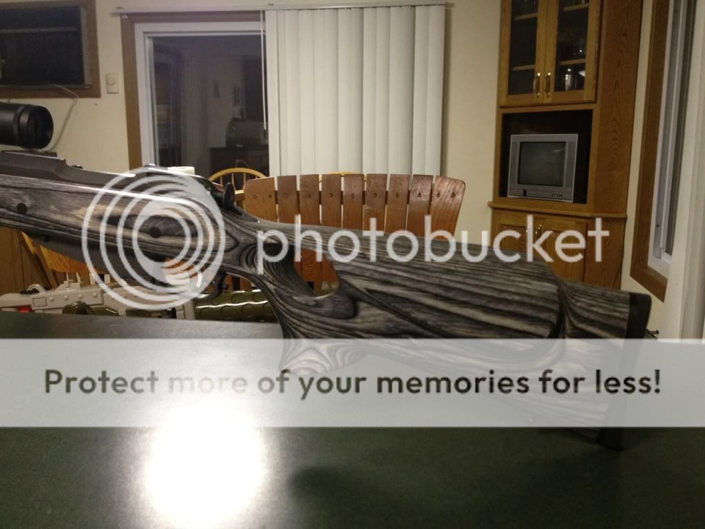

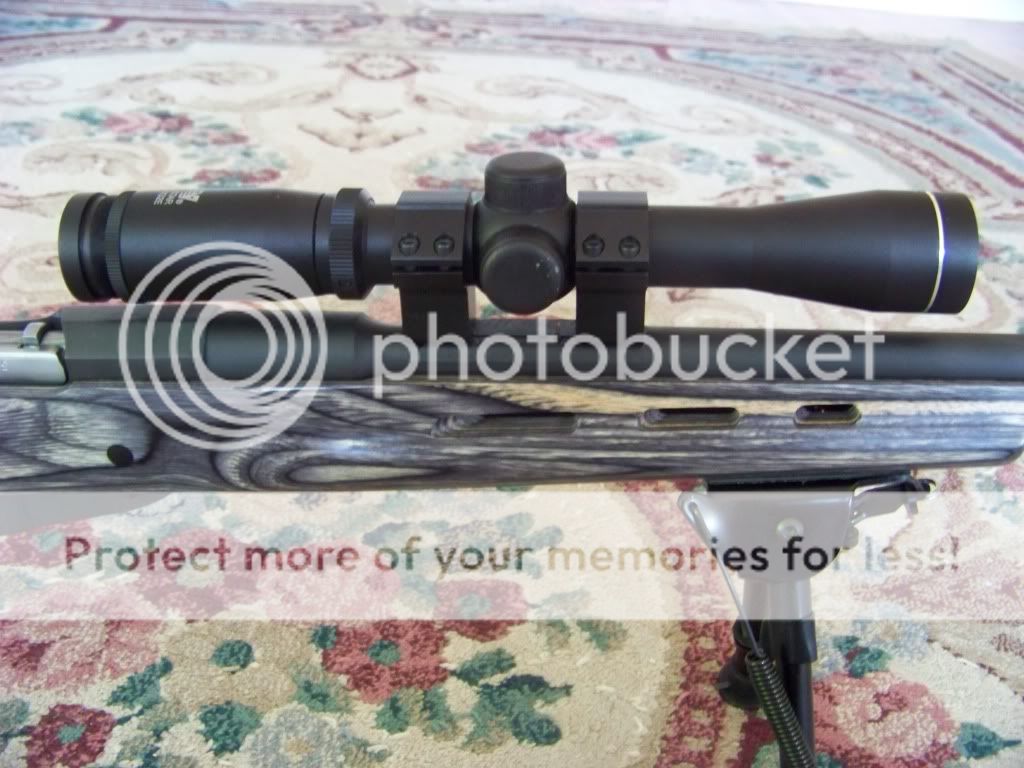

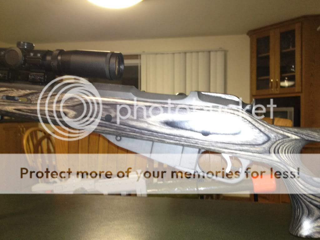

Postby hoel6466 on Tue Jun 05, 2012 8:26 am

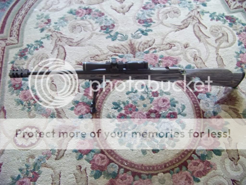

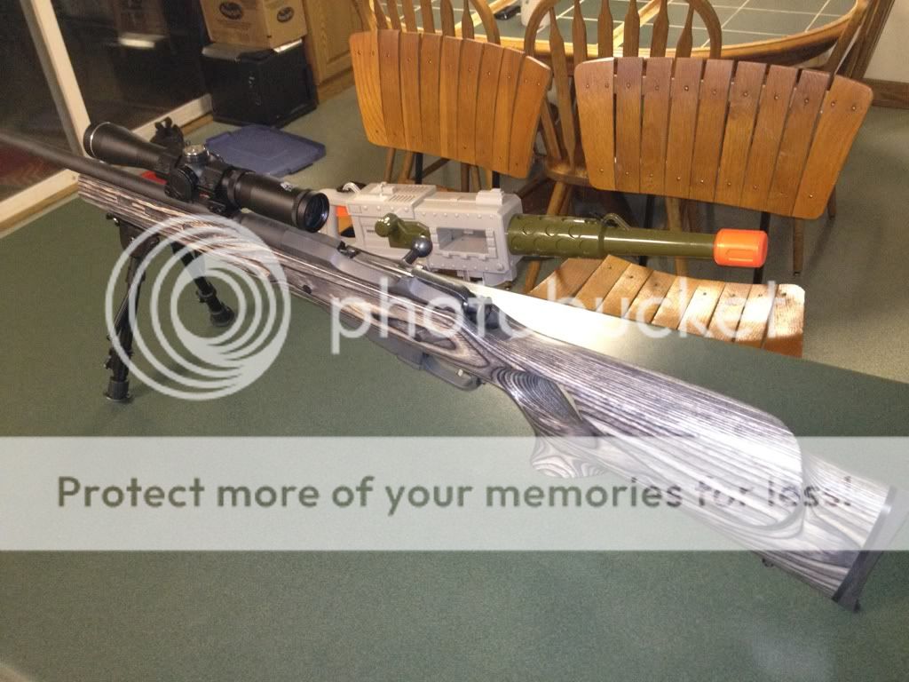

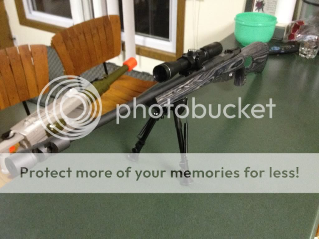

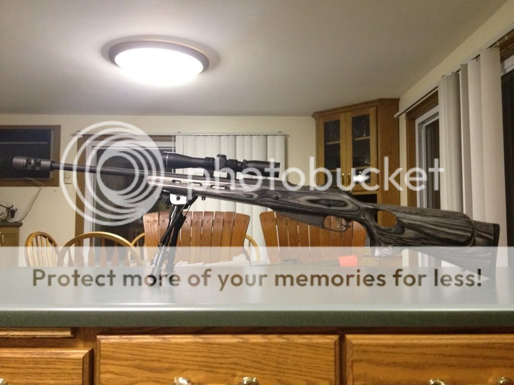

This started out as a hex receiver That had black paint covering areas that had been messed up by corrosion. I spent quite a bit of time learning how the rifle functioned and trying to improve the the feel of the bolt and trigger. It took me awhile before I figured out what I wanted to do with this rifle and in the end I think it turned out well .
List of mods

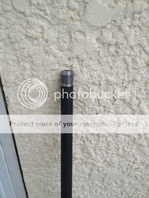

-Shortened barrel to 18" and threaded the end
-Purchaced a stock and pillar/epoxy bedded the action

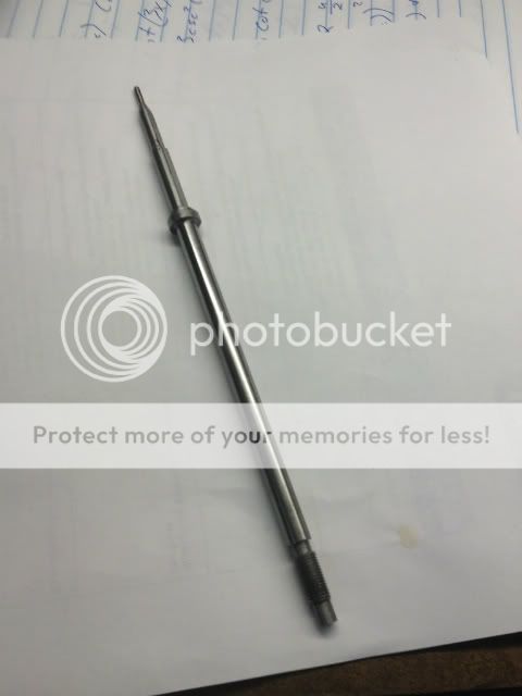

-Trued the bolt and machined a new firing pin to eliminate the slop,this also improved trigger feel
-Reworked the trigger:
------Trued the trigger on a surface grinder
------Installed larger trigger pin
------Shimmed the trigger in the receiver
------Purchased a Finnish style sear ( hands down the best money I've spent so far)
------Ground and polished the sear surfaces to give a positive engagement
------Installed a ghetto overtravel stop screw
-Installed a NCstar pistol scope on the 3/8" dovetail
-Installed a bipod

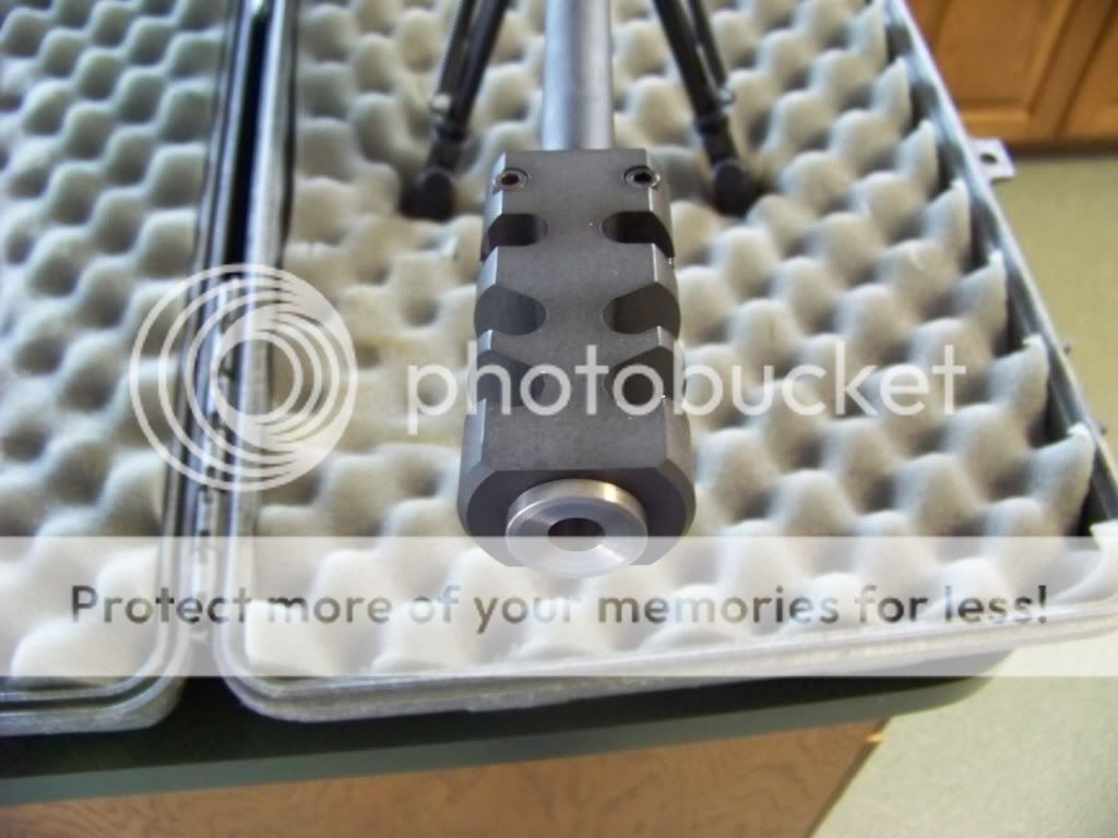

-Installed a custom muzzle break
-Parkerized the entire rifle
Gun $100
Stock $100
Sear $15
Scope $50
Bipod $35
Rings $6
Total $306

The pictures don't do it justice... Even after seeing it by flashlight at plblark's a while back. Feels good on the shoulder too.
Nice job man.

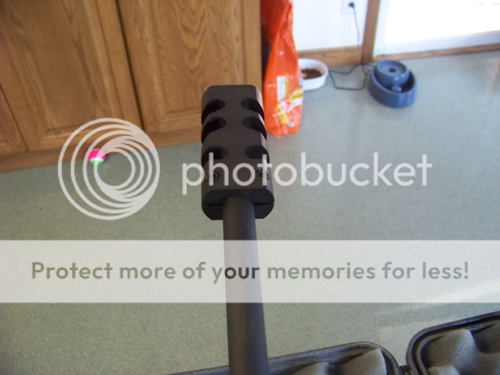

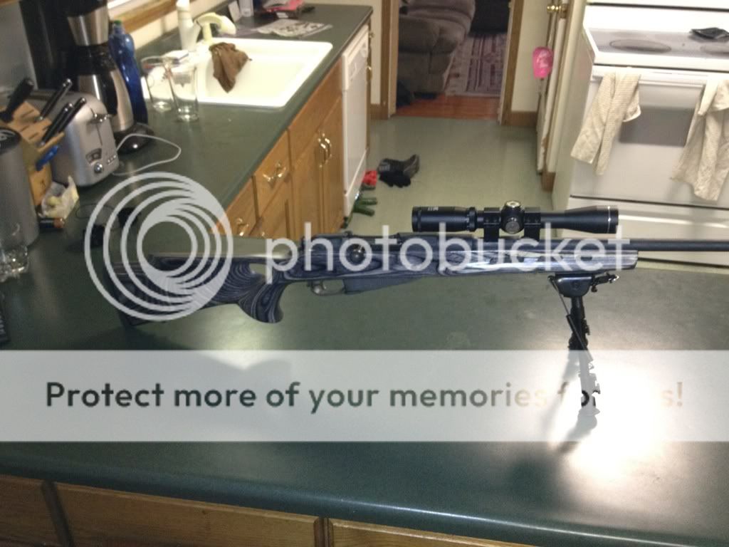

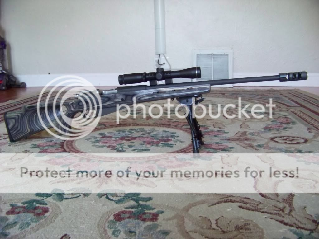

Postby hoel6466 on Wed Jun 06, 2012 8:19 am

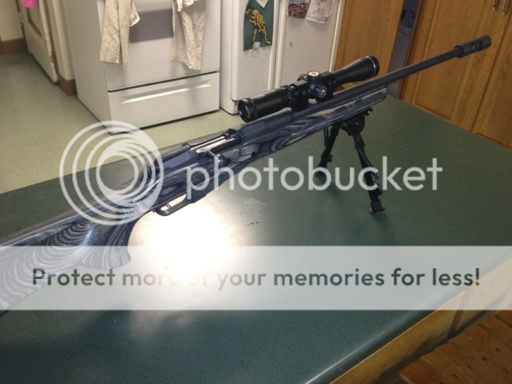

Here are a few pics with the new brake. I suck at taking pictures so bear with me.
Thanks for all the comments, it was a fun project.
