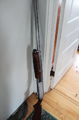

Postby Nokomis on Mon Mar 18, 2013 4:49 pm
The Verminator wrote:I've seen guns with worn-out bluing used for many, many years without problems as long as they got a wipe down with oil once in a while.
They look like veterans. Ain't a bad look.
I agree and think that the bare steel looks better than blued but I can't risk it rusting away. The guy who had it before more must have removed the blue before he duracoated it because this is how it looks after applying a couple coats of paint thinner. No blue to speak of.

Postby Holland&Holland on Mon Mar 18, 2013 7:46 pm
I can echo what others have said about Alhmans. They do some great hot bluing that would do what you are looking for, however in this case I would suggest you look into a duracoat or cerakote type job, would protect it like you want, likely could get done fairly quickly localy and for this type of gun would be a much more durable finish.
Posts: 12661 [View]

Postby JJ on Mon Mar 18, 2013 7:49 pm
If it came off with paint thinner it isn't duracoat. I would be willing to bet he went with good ol rattle can.

Postby Nokomis on Mon Mar 18, 2013 8:27 pm
JJ wrote:If it came off with paint thinner it isn't duracoat. I would be willing to bet he went with good ol rattle can.
I mistyped, I used a paint stripper/remover gel that works on epoxies. Still, it could very well have been normal paint that was used.
Thanks for the help everyone. You saved me time, $, and disappointment in trying to do it myself. I'm going to drop it off at GS Gunsmithing tomorrow(a lot closer and sounds like a little bit better turnaround time). I'll post a picture of the finished product and thanks again!
