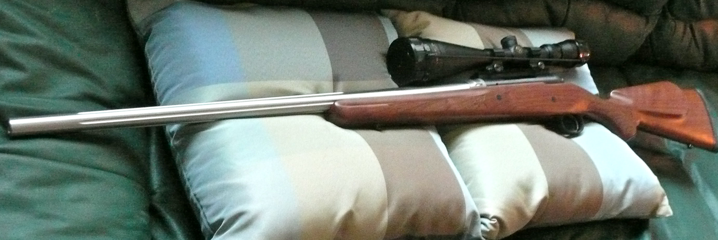

I Did ,with a lot of help from Don T the exact conversion your talking about,243 to 223,actually a pretty straight forward swap,,If i remember ,you need to change out the Bolt face and internal Magazine ,the rest is a matter of changing out the barrel,, I ordered a Boyds stock and opened up the barrel channel to accept the Varmmit Barrel ,,adjusted the standard trigger to about 3#,,got rid of the cheap plastic trigger guard,,and put a long range scope on it,, it,s a little nose heavy but it,s a bench rifle so who cares
