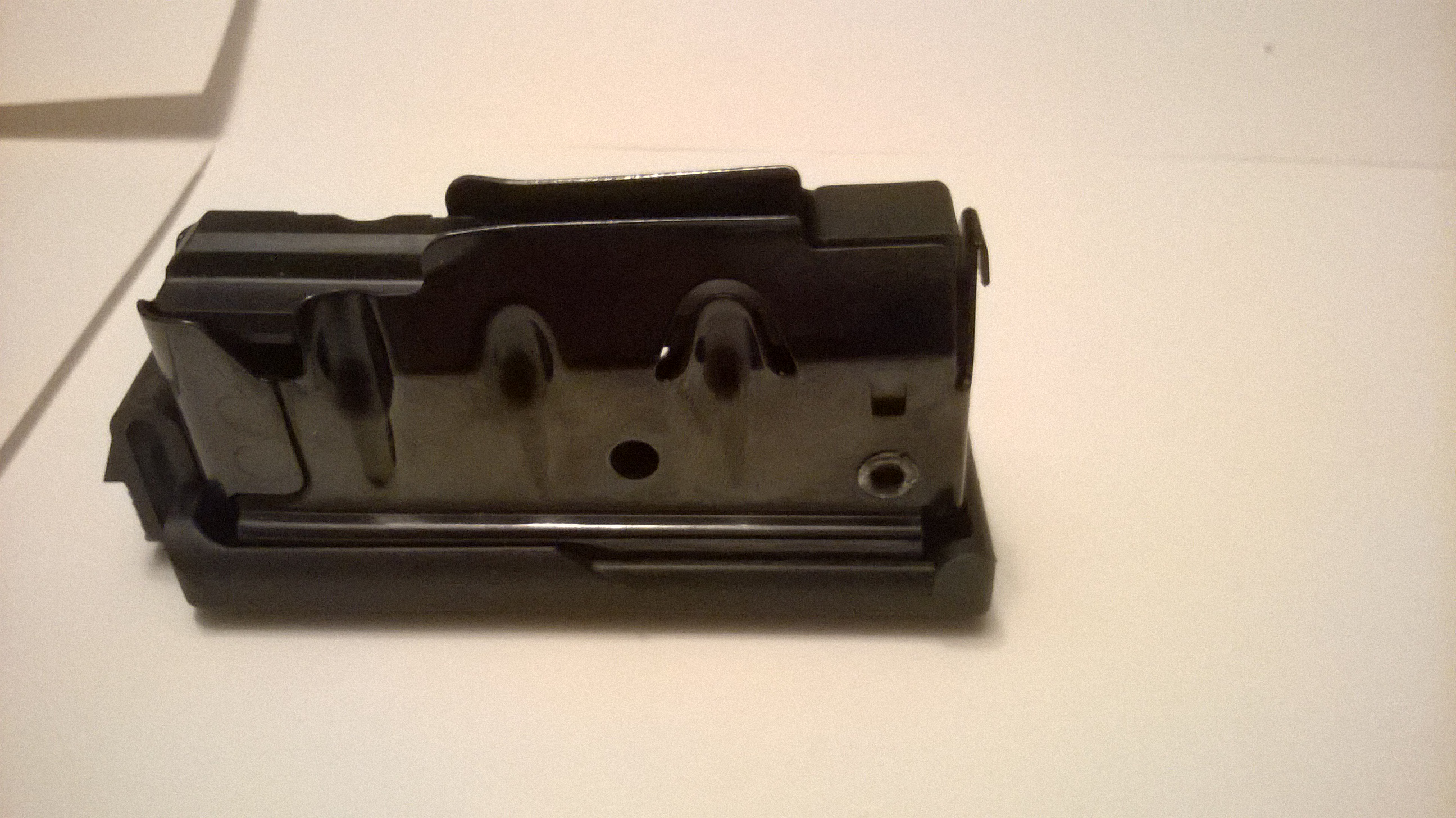

Postby purd0027 on Mon Jul 13, 2015 9:14 pm

Re: Savage Axis .223 - magazine falls out when firing
Postby The Famous Grouse on Mon Aug 03, 2015 10:17 am
Yes, that looks fine. The spring retainer I was referring to is on the right side, at the top of the magazine pictured.
When I broke my .223 Axis magazine, it broke right at the top where it's folded over and, of course, this is where it flexes ever time it's inserted.
Postby purd0027 on Sun Sep 27, 2015 10:03 am
Well, I bought a new factory magazine and now it works fine. Kinda a bummer the one that the rifle came with new was faulty.
