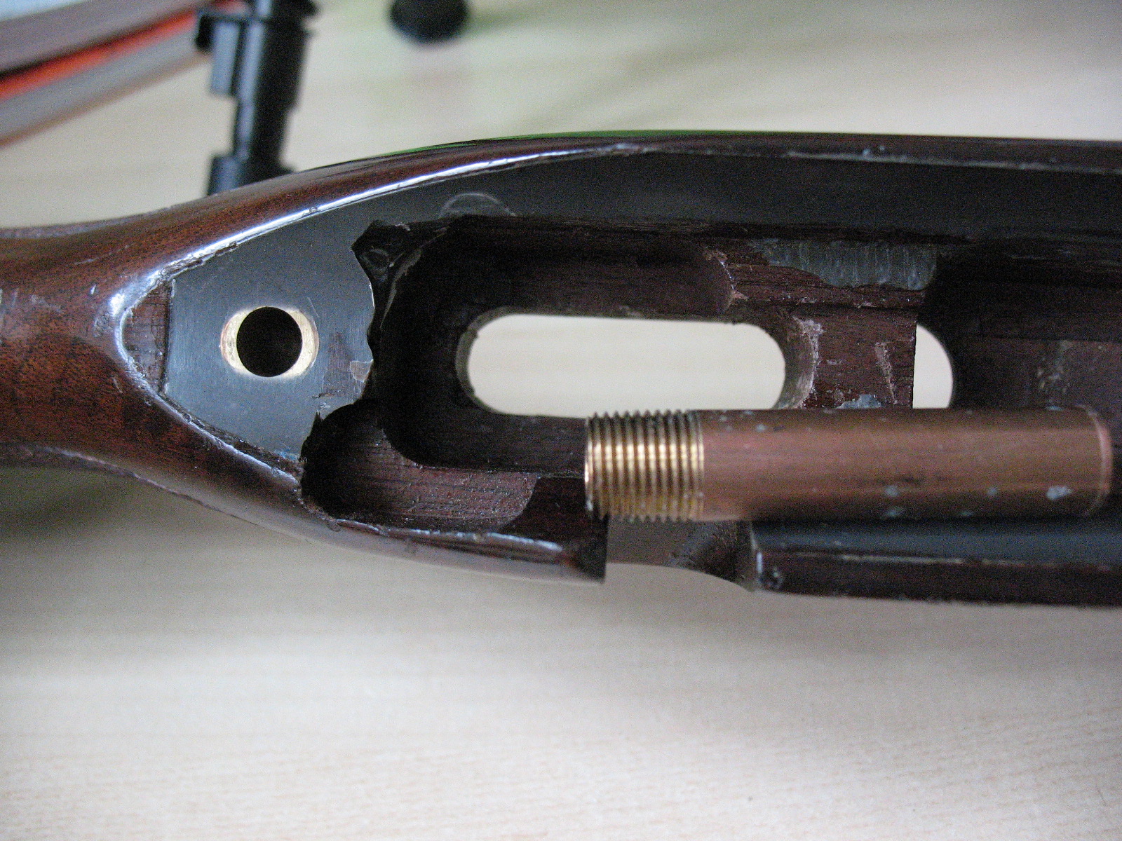

Last summer I pillar beded my rifle. I didn't do a very pretty job of it because I had plans to replace the stock anyway. I used Devcon and cut up some brass plumbing pieces for the pillars.

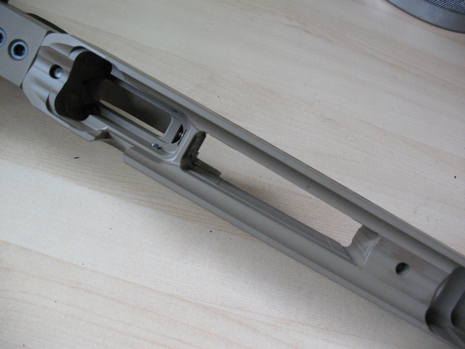

I thought I saw my groups go from about 3 MOA down to 2. Still wasn't the accuracy I wanted, so I blamed the barrel. I decided to wait until winter to have the rifle rebarreled, so the next thing on my list was a better stock. I went with a folding chassis. Here is a picture of the inlet:
After switching the barreled action over to the chassis, I thought I saw the groups open up to around 2.5 MOA. Honestly, with my groups being so big, it was hard for me to tell what was going on :oops:
