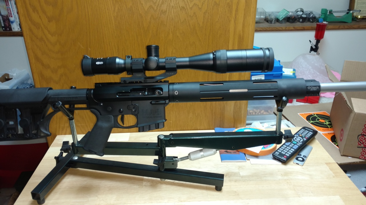

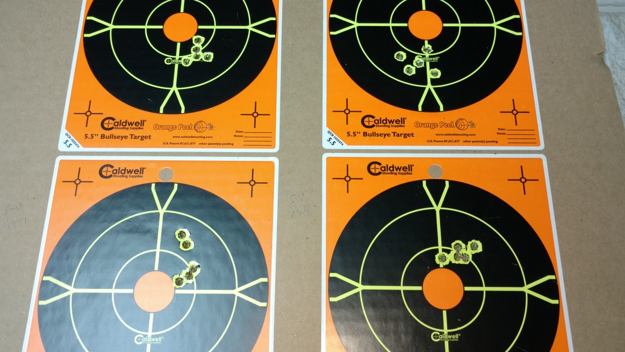

Postby samginko on Wed Jul 26, 2017 3:58 pm
Here is the D-tech upper I have been talking about. It is 20" bull barrel, forgot what the twist rate is. I sent in the upper receiver with the bolt and the D-tech installed the barrel and the handguard.
The target is at 200 yds (Oakdale), testing out four loads of 50 V-max. Biggest group is about 1 1/2" and the smallest group is at .71". This was after taking about a year off from shooting this rifle. I was also shooting pretty rapidly, all five shots within about a minute.

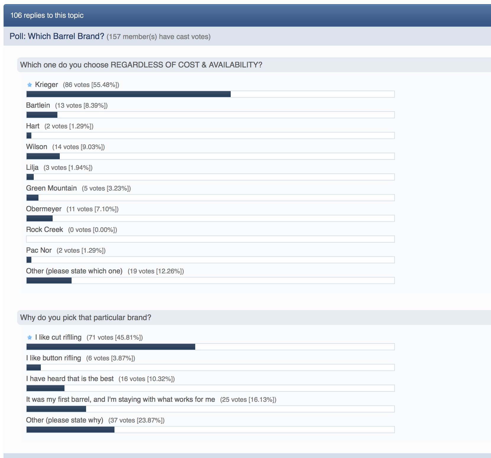

That's interesting. Over on the National Match forum they had this poll.
