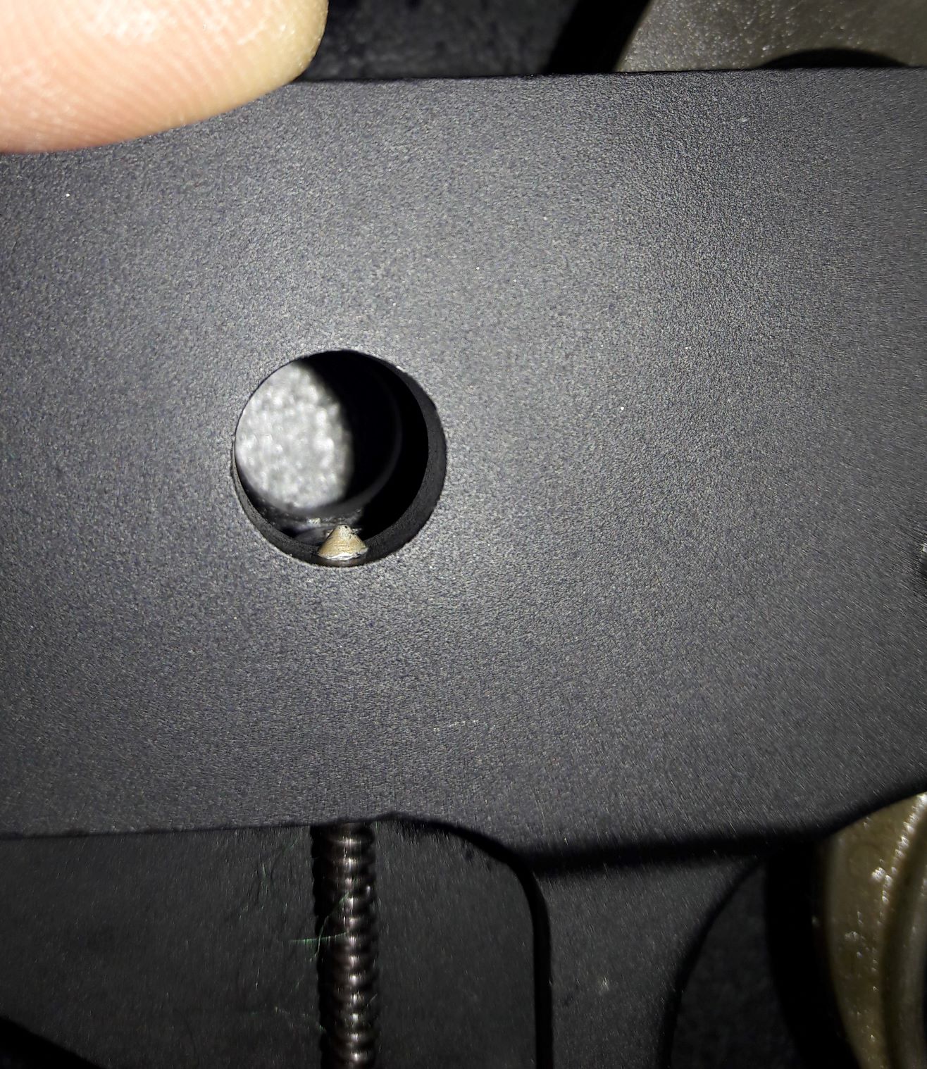

Postby purd0027 on Thu Jul 11, 2019 8:56 pm
I am trying to build a lower and am encountering issues with the selector. It doesn't seem to want to click to engage safety or click to select fire, just kinda swings loose. Detent is installed with pointy end first and I don't think I kinked the spring. Tried two different selectors, AR Stoner and Aero Precision, got a similar result with each. Lower is an Anderson Mfg. Is it possible that the detent hole is out of spec? I tried to pass a #22 drill bit through the hole (installation book said the holes should be cleaned by hand twisting with this size bit). Does this mean the lower is out of spec? Thanks in advance

Postby gun_fan111v2 on Thu Jul 11, 2019 9:40 pm
If you install the detent without the safety (selector), do you see it sticking out of the hole?

Re: Selector issue with AR build
Postby purd0027 on Sun Jul 14, 2019 7:04 pm
Sorry all, I'm having trouble uploading an image and having trouble generally posting :( Hope this goes through. I am using an a Magpul K2+ grip. The conical part of the detent sticks through, but not the cylindrical portion. I am pretty certain is the right spring. The drill bit does not go through - sorry it wasn't clear.
Postby purd0027 on Sun Jul 14, 2019 7:30 pm
Trying to reduce file size . . .
Postby Ghost on Sun Jul 14, 2019 7:42 pm
purd0027 wrote:Trying to reduce file size . . .
I’ve never paid any attention to this particular depth but that seems like it should work. Have you tried the selector while holding the detent and spring in as far as you can?
Postby purd0027 on Sun Jul 14, 2019 9:01 pm
Yeah I tried pressing in the spring and detent, no luck.
Postby Rip Van Winkle on Mon Jul 15, 2019 4:41 am
The detent isn't sticking through the hole enough, there must be a burr or something in the hole.
Postby Rip Van Winkle on Mon Jul 15, 2019 5:11 am
The channel in the sector is cut fairly deep. I don't think your detent is engaging it properly.
Postby purd0027 on Mon Jul 15, 2019 11:34 am
Rip Van Winkle wrote:The detent isn't sticking through the hole enough, there must be a burr or something in the hole.
Thanks all, I'll see if Anderson wants me to send it back or if they tell me to try to break out the drill. . .
