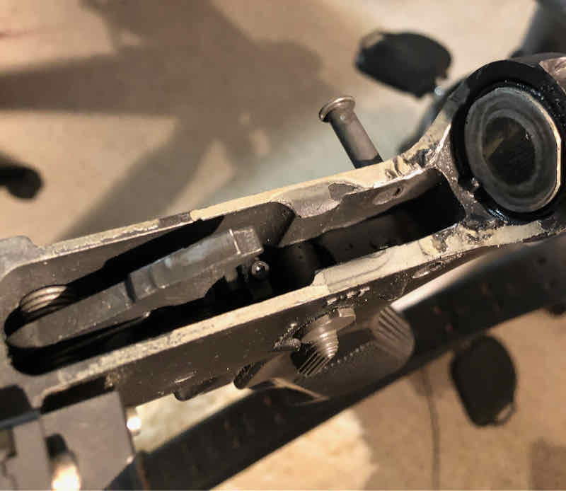

Postby Rip Van Winkle on Wed Dec 09, 2020 6:53 am
I took a picture of my Service Rifle. The bedding starts at about the hammer pin and goes half way up the heal of the lower.

Postby Holland&Holland on Wed Dec 09, 2020 12:34 pm
Rip Van Winkle wrote:I took a picture of my Service Rifle. The bedding starts at about the hammer pin and goes half way up the heal of the lower.
I never would have even thought of that possibility. I will a couple that I might give that a try on.
