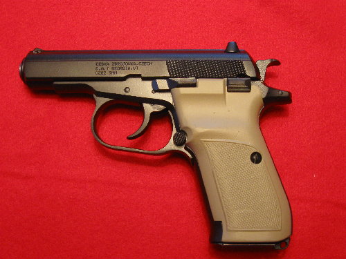

Here's a CZ 82 I picked up recently.
I liked it because it's been refinished. A lot of these surplus 82's are pretty rough. The tan grips look great.
Haven't had a chance to shoot it yet.
