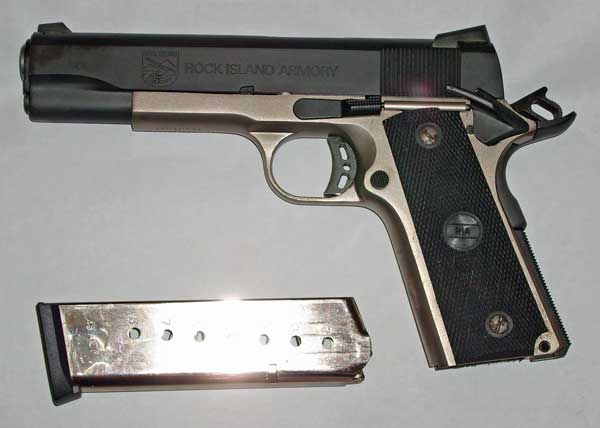

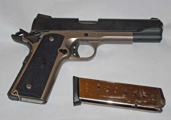

Well, I didn't fix it, someone else fixed it for me. :oops: I did get a kick out of the speculation that I had actually detail stripped it myself, couldn't put it back together, and either didn't know it or didn't want to own up to it. Trust me, if I tried to detail strip a 1911 for the first time, I'd be posting a thread on here asking "how do I put this thing back together?" I did find a lot of complete 1911 detail strip guides with pictorials on the web though. Still, the first time I do it I'll have someone with me who has done it before.
Anyway, pictures as asked...
