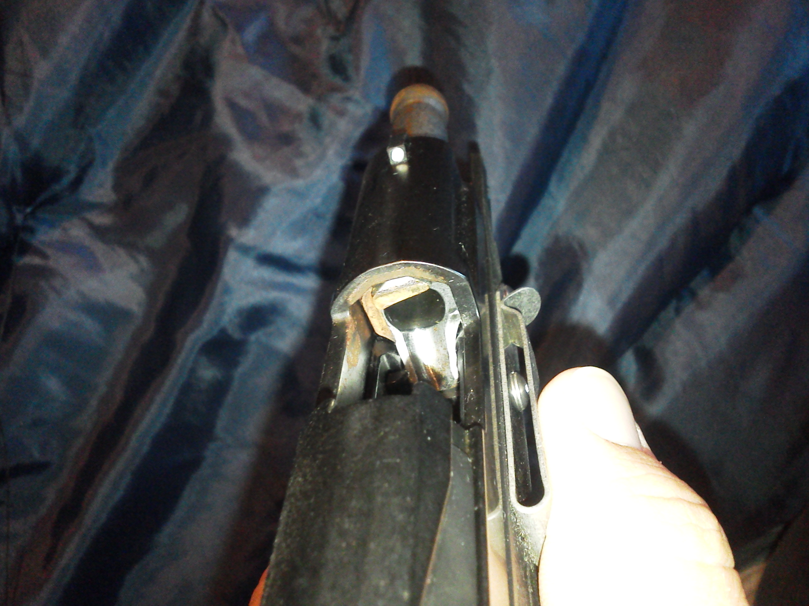

I just purchased my pf9 from my local Scheels about 12 days ago, I haven't had 1 FTF/FTE, But I got a worse problem. ~Rust~ I keep it well oiled using Fp-10 which has served well for ALL my firearms the past 10 yrs, But I now have surface rust on my pf9? this pic was taking this morning before my Jog.
