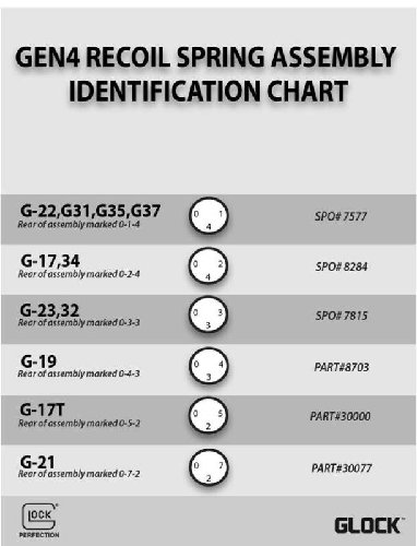

centermass40 wrote:Your recoil spring should be marked 0-4-3. Did you have problems with all three of your mags or just one ? What ammo were you shooting, reloads or factory ? I would stick with factory OEM parts for now.
I have shot several Gen. 4 19's with no issues.
Same numbers different order. 0 on the left, 4 on the right, 3 bottom center
Yup it's the updated recoil spring. I'm going to give CS another call and hopefully get someone on the line that gives a $hit.
