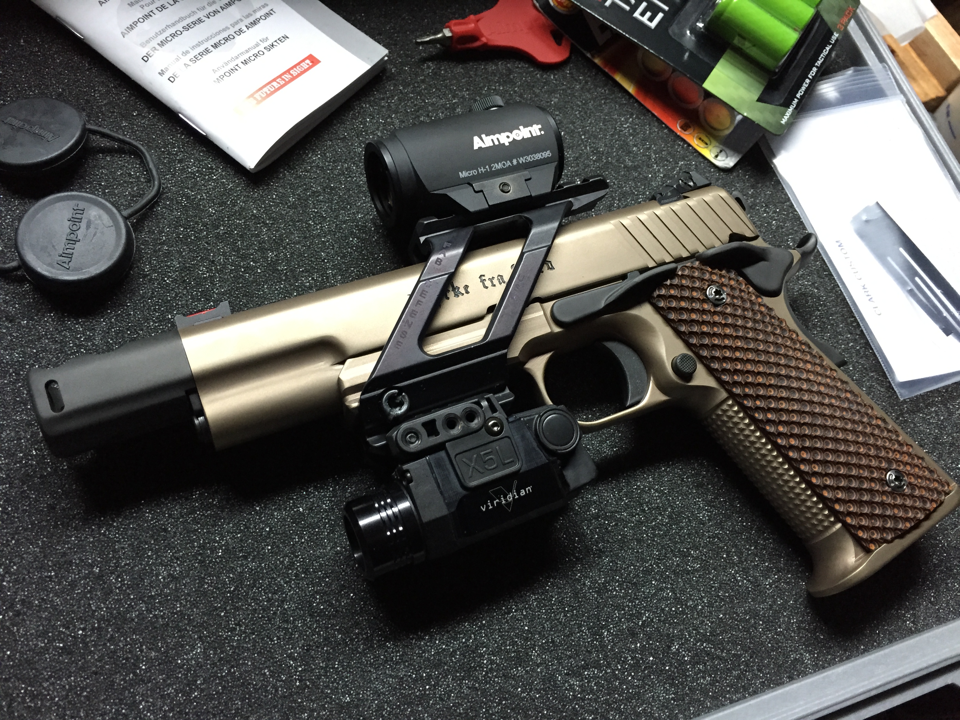

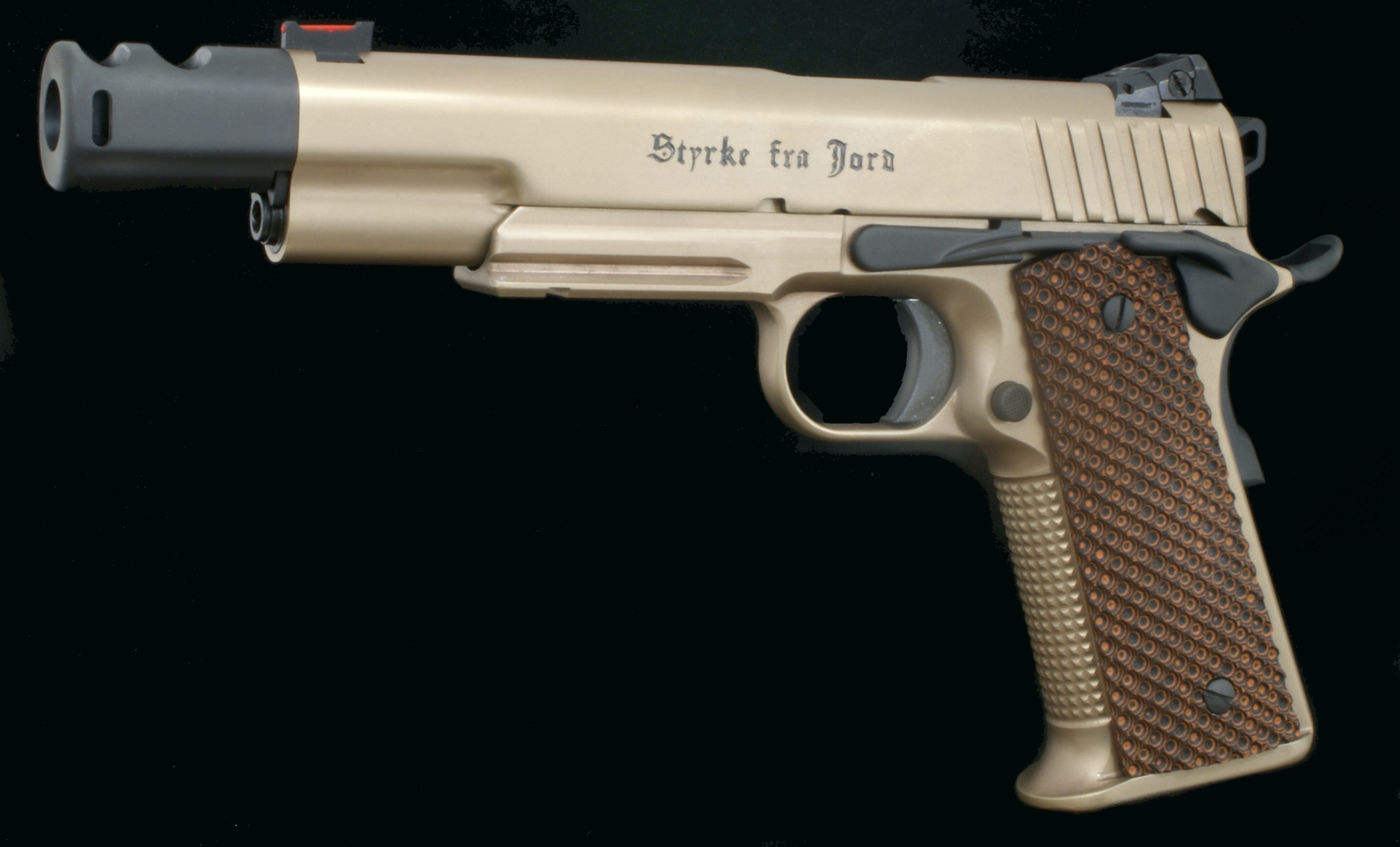

So this has been 2 years in the making, mostly due to all the custom specifications I imposed, but I finally got the asskicking single stack homage to the 1911 I wanted and I love it. All for the price of a Nighthawk T3 or Costa.
Clark Custom 460 Rowland (with 45 super threaded conversion barrel)
Parts:
    STI Slide
    Caspian Recon Race Ready Frame
    Clark 460 Rowland Barrel with Comp
    Clark 45 Super barrel extended to 5.75" for suppressor thread
    STI Grip safety
    Wilson extended Slide stop
    STI Thumb Safety
    EGW tungsten Guide Rod
    STI trigger internals
    Harrison Design Trigger
    VZ Strider G10 Grips
    Dawson Front site
    Caspian Adjustable tactical rear site
Processes:
    Slide accuracy fitting
    throat and polish
    Lower ejection port
    Bevel mag well
    custom knurling on front strap and main spring housing
    Trigger job
    Full meltdown and dehorn
    Engraving (By the same guy who did President Bush's commemorative Gun)
    Ionbond all parts
This is with my Aimpoint and X5L attached (for giggles)
The thing kicks like a mule even with the comp, my current loads throwing 230g XTP's about 1375 FPS, and 185g XTP's about 1500 FPS.

All right, color me slightly GREEN with envy. Are those ballistics for the 460 Rowland?? I suspect they are, since 45 Super "spec" is a 230 grain @ 1200 FPS. Also, what are you using for powder??
And at 1375 FPS for the big 230 slug, I can imagine the gun kicks like a sumbitch. If you have any friends with high frame rate cameras, you should get some pictures of the muzzle blast.
Oh, and what does the engraving on the slide say? From the spelling I'm going to guess that it comes from 5 or 6 centuries back. I'm going to make a wild guess that it means "Strike for the Lord", but what do I know??
Very cool piece!!! 8-) 8-) 8-) 8-) 8-) 8-) 8-)
Re: Clark Custom 460 Rowland / 45 Super Build
Postby Squib Joe on Thu Oct 16, 2014 9:29 am
Looks like some 44Mag ballistics to me
Help with the translation .. Strength From ....?

Squib Joe wrote:Looks like some 44Mag ballistics to me
. . .the North" ?

It means "Strength from the Soil", the North Dakota state motto. ;)
