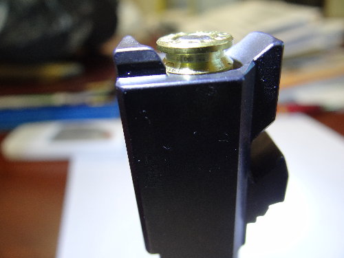

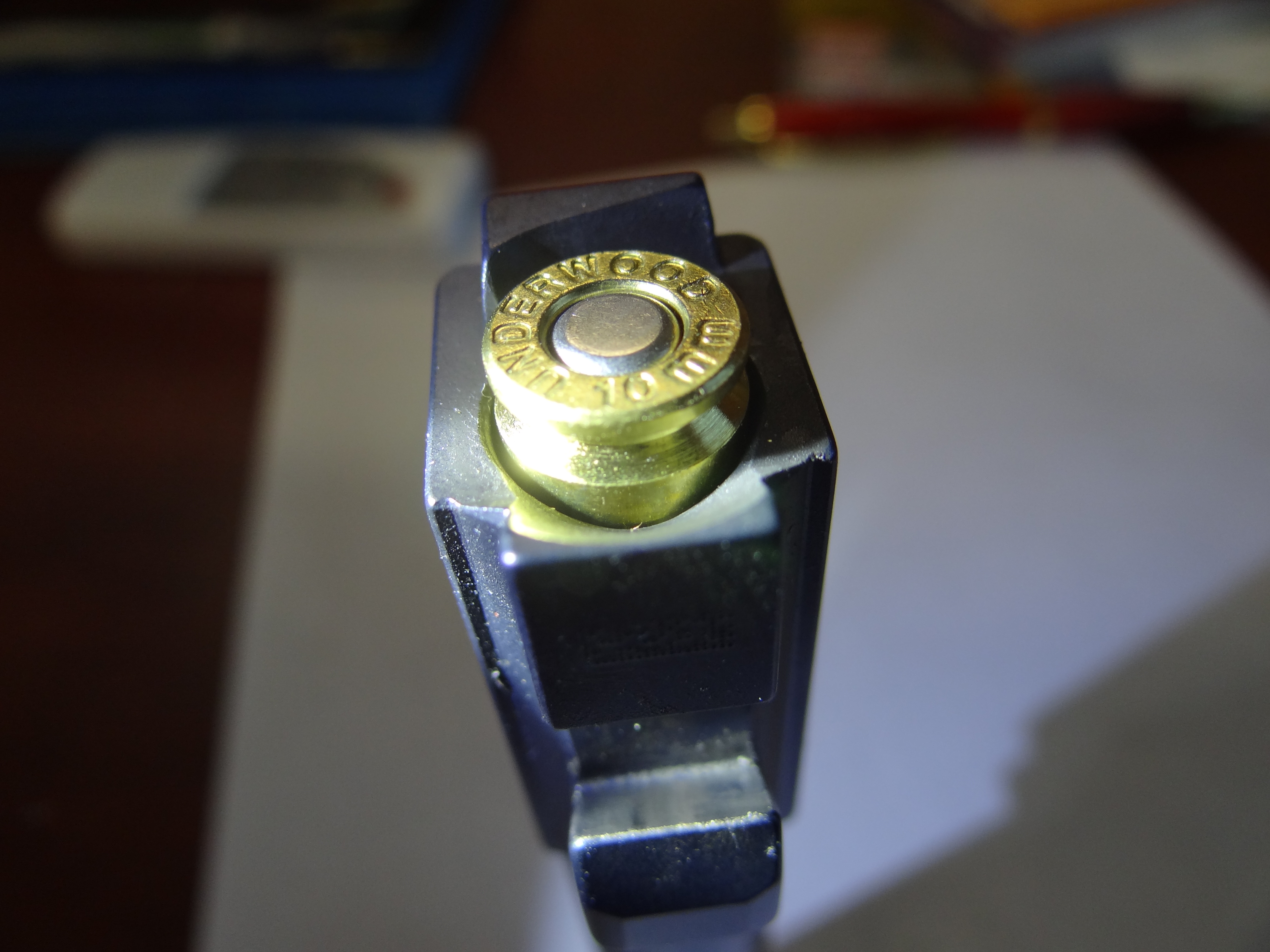

Just for S&G's, take a close up of a 10mm round sitting in your Gen 4 Glock barrel from the underside of the feed ramp and post it so we can see how close it is having full support.

Re: Glock G20 Gen4
Postby Seismic Sam on Sat Jun 07, 2014 6:17 pm
Thanks, Doc!! While the Glock Gen 4 case support is a lot better than an original Colt Delta Elite barrel:
it looks to be NO BETTER than a Glock Gen 2 10mm barrel shown on the left:
that produces a bulge this big:
Finally, NONE of the above satisfy what Underwood claims that ALL Glocks do, and that is provide FULL chamber support such as this EAA barrel:
Now let's be clear: I am in no way bashing Glocks here, but I am saying that the Underwood disclaimer is complete hogwash, and in 10 minutes on the internet you can find pictures like these that prove it!! And this is from a company that sends out ammo with gross defects as shown in this thread, and velocity levels that are higher than the published data in ANY reloading manual ever printed, or the factory specs of any other 10mm load that doesn't have a disclaimer concerning case support of the 10mm cartridge. Do you REALLY want to put your own safety and health on the line when it's clear that their own disclaimer is including guns (for the sake of Underwood selling more ammo) that clearly do not meet their OWN criteria for "full case support"?? And they're going to give you $5 off on your NEXT order after sending you a cartridge which is THAT defective??? :roll: :shock: Well, we're back to the analogy of the hooker who gave you a dose, and is now promising $5 off on the next time you come back to see her... Good luck with that box of ammo, and I hope you can shoot the whole thing with no problems. If it were me with a brand new gun, I'd think twice about shooting that stuff and just chalk up the $40 lost to experience and buy something else.

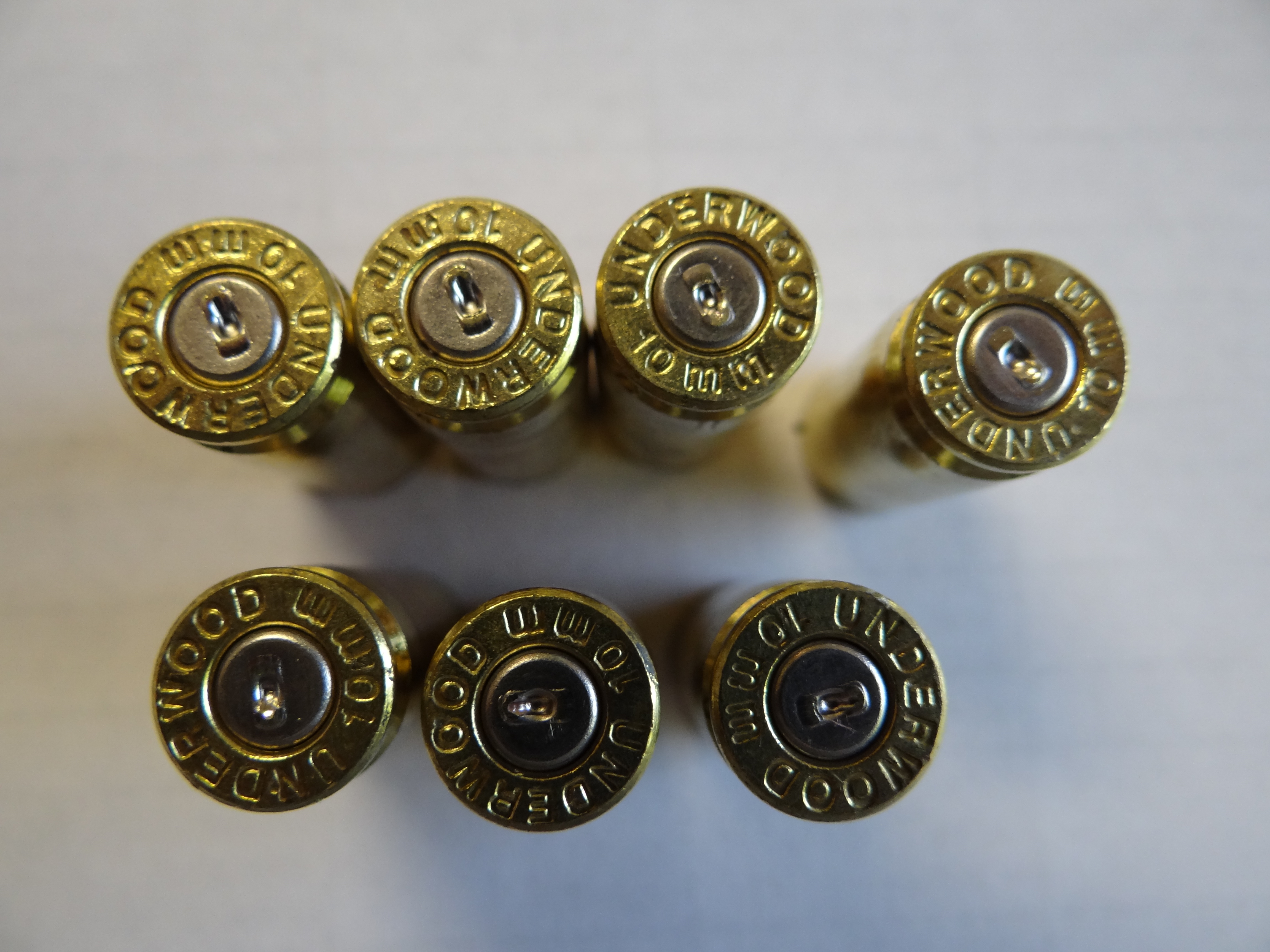

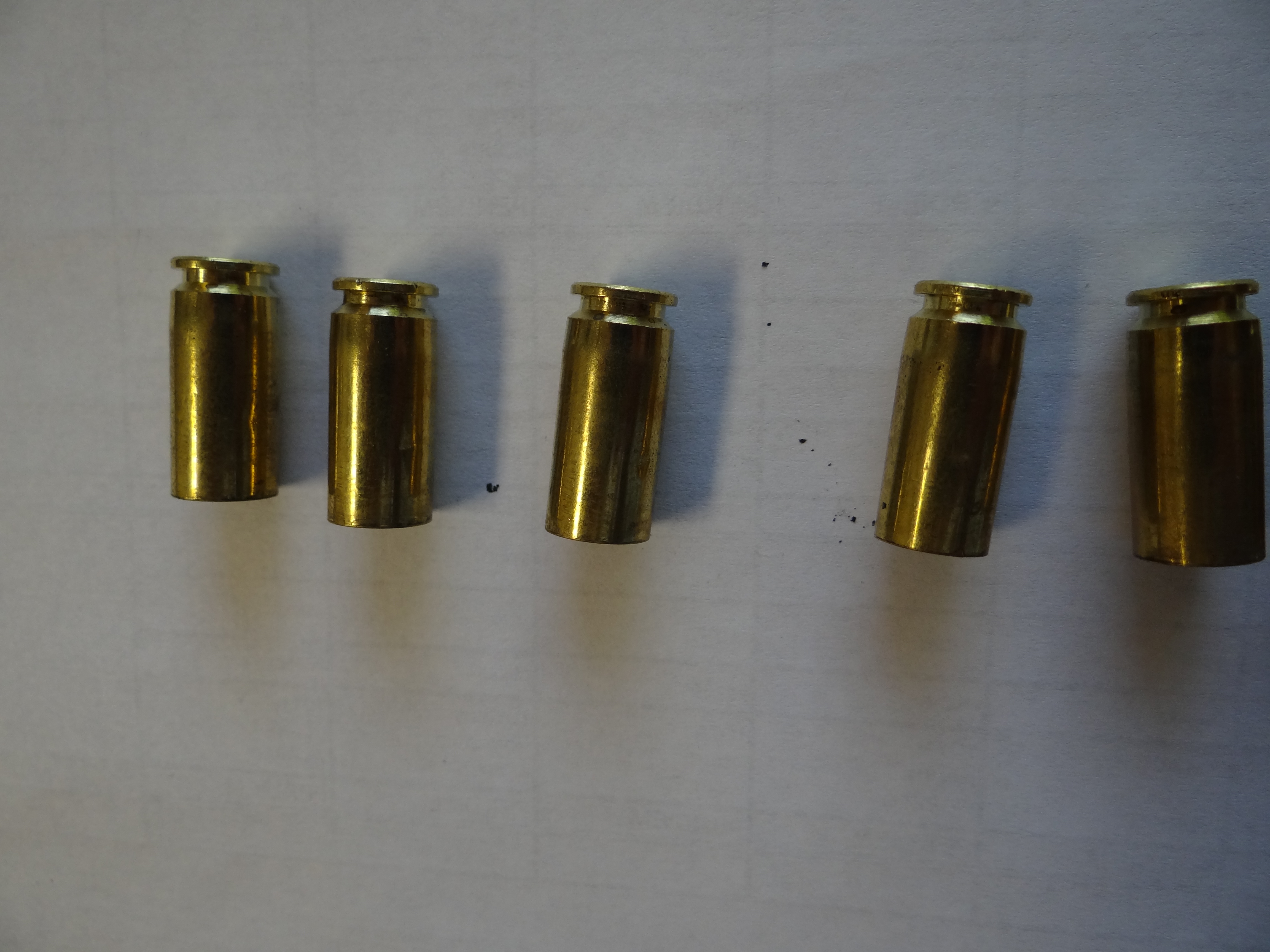

Postby brad3579 on Sat Jun 07, 2014 8:25 pm
Seismic Sam wrote:Just for S&G's, take a close up of a 10mm round sitting in your Gen 4 Glock barrel from the underside of the feed ramp and post it so we can see how close it is having full support.
Here are close up barrel and spent Underwood 180 gr casing pics.
brad3579
Posts: 611 [View]
Location: Lino Lakes
Re: Glock G20 Gen4
Postby Seismic Sam on Sat Jun 07, 2014 10:40 pm
Cases look OK, primers are flat, but not excessively flat, so those 180 loads look like the max but not over the edge. I've reached 1300 with 180's in my EAA and my Delta Elite, and that's exactly where I stopped. The load that Underwood has that is scary is a 200 grain 1250 FPS load, and you couldn't pay me to shoot that in a Glock OR Delta Elite. 200 grains at 1200 FPS was the original spec, and was considered hotter than hell, and it did in a number of the early 10mm pistols that are no longer around. While going 50 FPS faster doesn't sound like much, you have to work up to 1200 FPS before you realize how far out on the limb you are, and what's likely to happen if you push it any farther. I got to 1400 with 165 grain bullets, and two tenths of a grain beyond that I got two bulged cases, even though my chrono didn't indicate any larger velocity jump at all. I consider myself lucky that I got a warning before the gun blew, and that's the thing about the 10mm: It's hot enough that if you go over the edge it may let loose on you with no warning at all. If you keep a close eye on your fired cases as you shoot them, the 180's will probably be fine, but look out for that 200-1250 loading.
