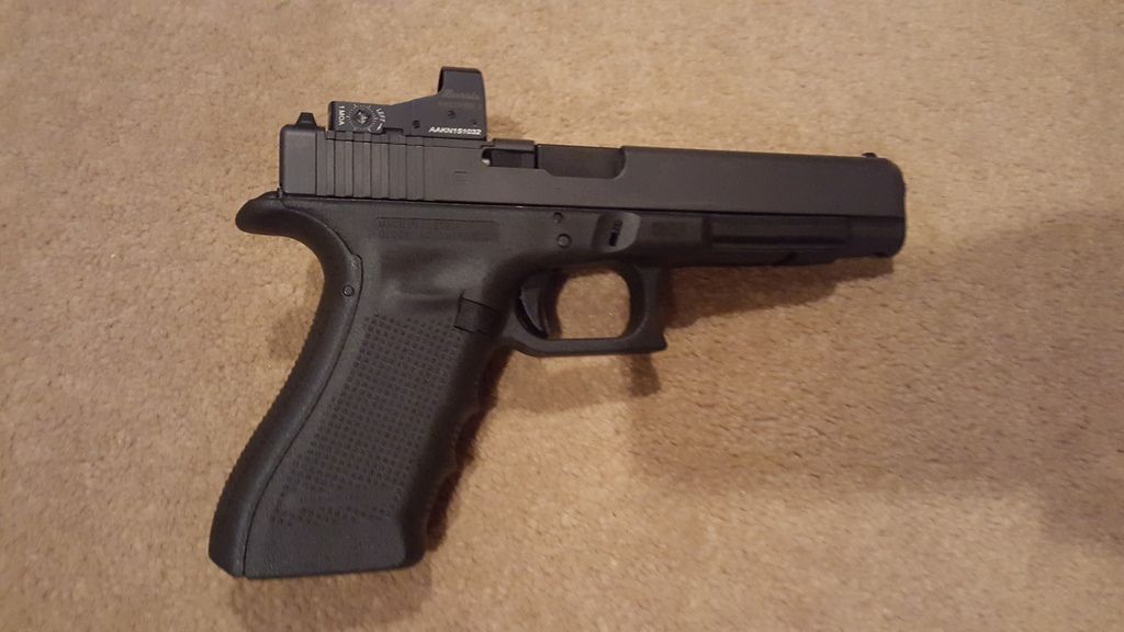

Postby mmcnx2 on Fri Feb 26, 2016 7:43 pm
New toy is ready for the range.

Postby LumberZach on Sun Feb 28, 2016 7:29 am
Looks awesome! Is that a fastfire? Did you do anything to install it more than what the pamphlet said that it came with?
LumberZach
Posts: 847 [View]
Re: 34 MOS
Postby mmcnx2 on Sun Feb 28, 2016 7:52 am
I used plate #1 which lined up perfect. I used the Glock supplied screws to mount the plate to the slide. The Fastfire III supplied mounting screws are not the same size as the holes in the plate, nor are the Glock provided screws long enough. So I purchase 3mm x 8 screws and had to file a few thousandths off the length in order to insure they did not extend beyond the thickness of the plate. I used a touchup bluing pen on raw end of the screws, added a drop of blue Loctitie on each and mounted the optic.
I did confirm with Burris the screws size being slightly smaller was adequate and they confirmed the pins hold the sight for horizontal movement the screws simple hold the optic down to the plate and the smaller screws provide more than enough strenght.

Postby LumberZach on Sun Feb 28, 2016 2:13 pm
Did you find any torque specs by chance, or finger tight using the supplied wrench? I'm also wondering if it would be a good idea to put a thin layer of loctite between the slide and the mounting plate to help bed it a little bit.
LumberZach
Posts: 847 [View]
Re: 34 MOS
Postby mmcnx2 on Sun Feb 28, 2016 2:53 pm
Glock recommends oiling the plate lightly before installing. Assume that is reduce the risk of corrosion. No torque spec on any of the screws were provided so yea I used hand tighten firmly.
I'd not use the Loctite on the flat surfaces, the plate is locked front to back by the milled slot, it has a key in one corned to prevent side play and has 2 screws with threadlocker holding it down.
I'll shoot a few hundred rounds and keep an eye in things.

Postby LumberZach on Sun Feb 28, 2016 3:40 pm
Excellent! Update if you have any troubles. I've heard rumors of the optics coming off, but that seems to be spread by the guys that mill glocks for optics from all that I can tell.
LumberZach
Posts: 847 [View]
Re: 34 MOS
Postby mmcnx2 on Sun Feb 28, 2016 3:45 pm
A number of them also try to use the Glock supplied screws also and don't confirm the thread depth. In my case the supplied screws would have only engaged 2-3 threads Not enough clearly.

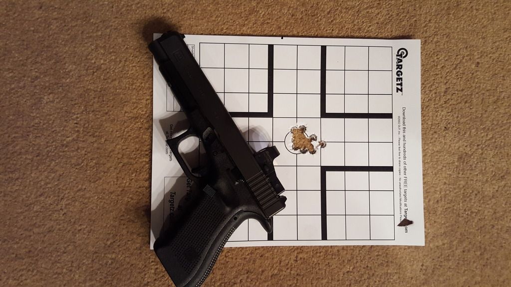

Postby mmcnx2 on Sun Mar 20, 2016 12:58 pm
30 rounds at 30 feet, not bad!

Postby mmcnx2 on Thu Mar 24, 2016 4:29 pm
Installed a ZEV V4 connector, competition springs and ejector housing. While I had it apart I hand shined(as in lightly polished without grinding) the contact surfaces.
Overall very nice improvement, dropped trigger to slightly over 3lbs, still has some pre-travel but manageable.
Ain't no 1911 trigger but very clean for a striker fire.
