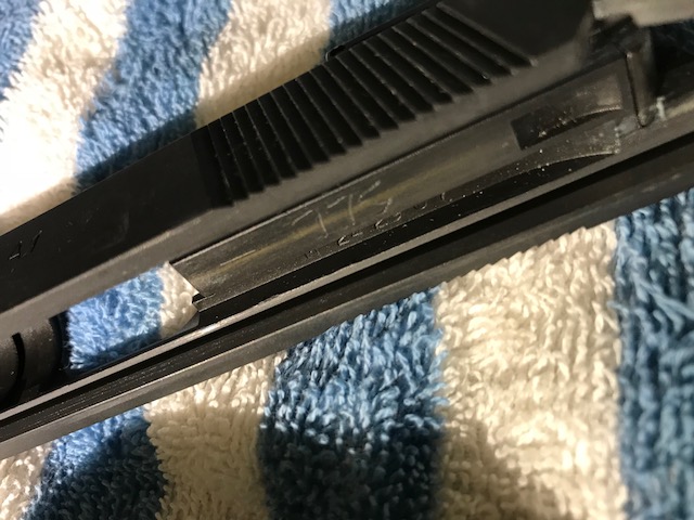

But now here's a question- when investigating for burs, rough patches, etc, I looked at the underside of the slide. It looks like someone took an electronic 'pen' and scribed in the number 775- see pic. (?) I've never seen this done before. Is this normal? The slide inscription seems like it would ride roughly over the disconnector.

Are 775 the last three digits of the guns serial number? That is the usual place manufacturers put that to keep the frame and slide together as the gun goes through the build and finish process.
