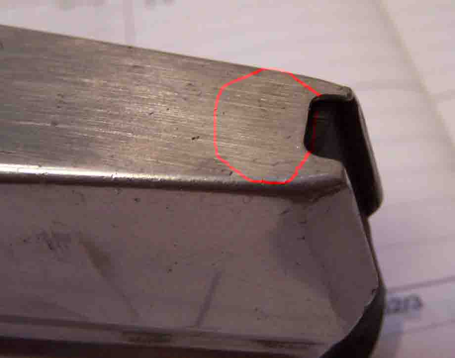

So I picked up an XD45 yesterday, it's my first XD. I noticed right away that neither mag drops free when I depress the mag release. Love the pistol, but this doesn't seem right. After looking around XDtalk I noticed others have had the same problem and Springfield has replaced them. So I called Springfield this morning, and they want me to send both the mags back for inspection (at my expense) and then they will replace them if found defective. In the meantime I'll be without mags. Also, the mags rattle when fully loaded. With decent mags this seems like a badass pistol.

Check this area on your magazines, you may find as I did, that the magazine kinda bulges here and that's what causes them to not drop free. I fixed mine, probably temporarily, by adjusting them with a tool appropriate to the job. I think I may have used a light hammer and possibly a pliers, YOU do what you think is right :D
I did have an XD 9mm, in fact I had two, both gone now but never any problems with the 9mm magazines. I have seen the magazine problems with three different, and older, XD 45's.

The rattle is normal and is a result of the double stack.
When the XD came out there were problems with the magazines doing what you describe because they bulged a bit. My understanding is that new mags are being made that are stronger and don't have that issue.

Postby grousemaster on Fri Dec 02, 2011 2:18 pm
Thanks for the input guys. I went up to Streichers and picked up another XD45 mag. Guess what? It drops free and looks different. It has a duller finish and the Springer logo. It drops out smooth as silk. My mags do indeed have the bulge shown in the picture above. Apparently Springfield had to change the mags...but I guess it's not a "recall" ? Who knows. Rather than pounding these mags straight, I'll just send them back for some good ones.
