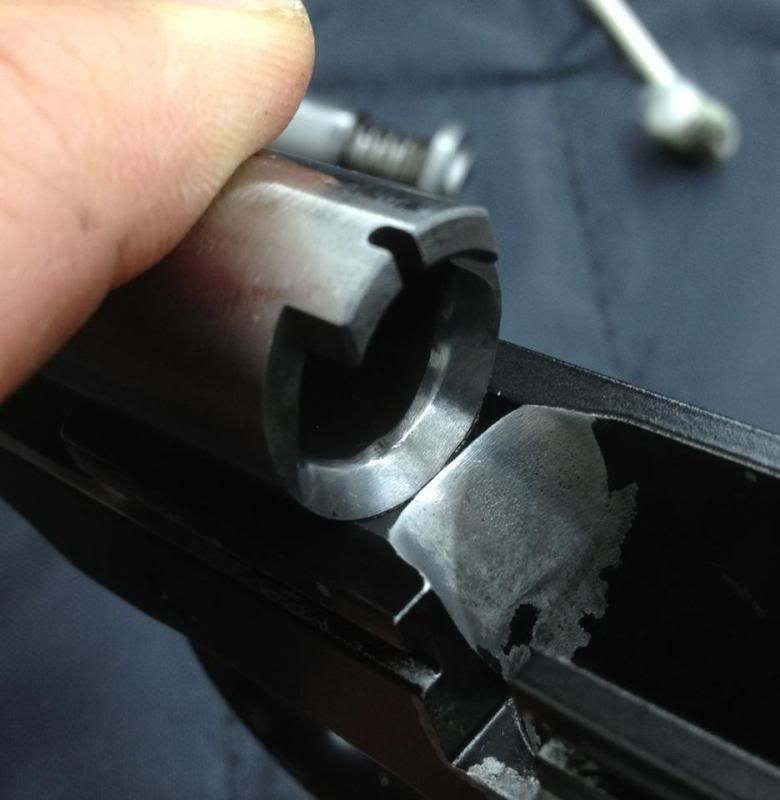

I currently carry an aluminum framed Springfield, but looked at this photo of an aluminum framed Kimber from 10-8's facebook page: That feed ramp looks like it has issues. He says the anodizing is wearing off. There was also a separate issue with barrel setback from the factory, which is unrelated.

To me it looks like someone "polished" the feedramp on the frame their by removing the anodizing.. This is NEVER done on an aluminum frame!
If the anodizing was chipping off, like it is in a few areas, it would not be so evenly removed at the feed ram area. Polishing the feedramp would also explain the barrel set-back shown.
Someone polished the feedramp on the aluminum frame. The only fix is a new frame or a steel insert into the feedramp area of the frame. Both expensive.

The 10-8 guy, Hilton Yam said that the ramp hadn't been done til he worked on it himself. When I have time, I'll copy and paste his comments.

tman wrote:The 10-8 guy, Hilton Yam said that the ramp hadn't been done til he worked on it himself. When I have time, I'll copy and paste his comments.
I can see where the anodize has chipped of into the magazine well, but it is so evenly removed on the feed ramp, that someone had to polish it off. No way would the anodize chip off so evenly and symetrically. When they "polished" it off, they removed so much material that there is not the minimum 0.030 gap from the feedramp to the throating on the chamber.

westhope wrote: When they "polished" it off, they removed so much material that there is not the minimum 0.030 gap from the feedramp to the throating on the chamber.
Yam said that it came without the proper gap from the factory.
