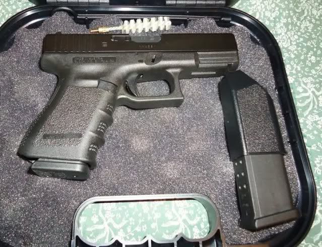

easy fix,
you're welcome

If you've got that in a single stack with a 3" barrel I'll take 2. :)
