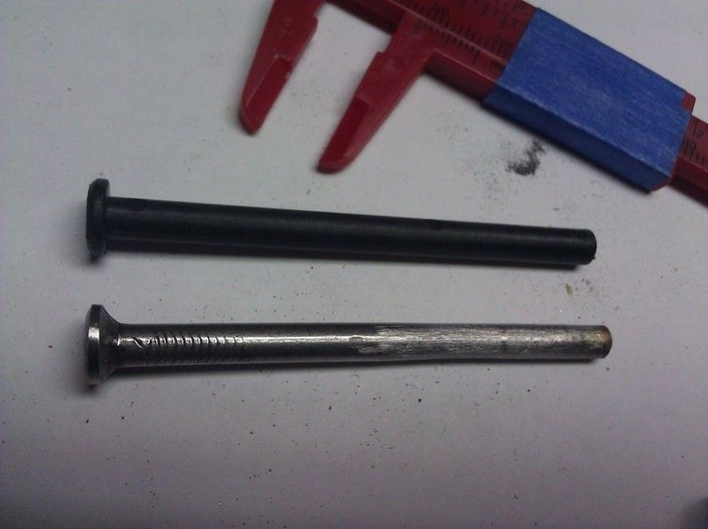

So I bought a kel tec pf9 today and I think it's a pretty neat gun for the money. While tearing it down for it's first cleaning I was surprised to find that they used really flimsy plastic for the guide rod.

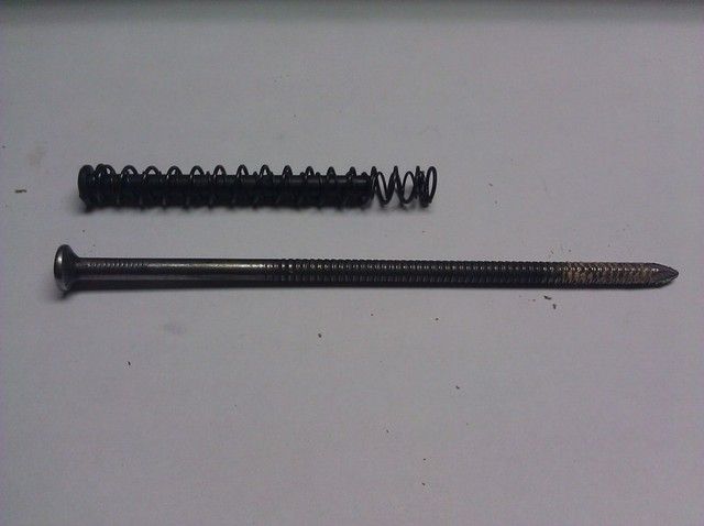

After I was done cleaning everything I was looking at the parts laid out on my cluttered workbench when I noticed a large framing nail which got me thinking.
There were a couple little differences but the nail was a near match. The head of the nail would need to be reshaped, the teeth would need to be smoothed out and it would need to be cut to length. Not ideal, but it would work.

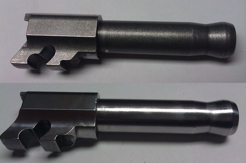

While I was at it, I decided to polish the barrel too.
In the end it turned out a lot better than I expected. I double and triple checked everything to make sure all the measurements were exact and it assembled and cycled flawlessly.

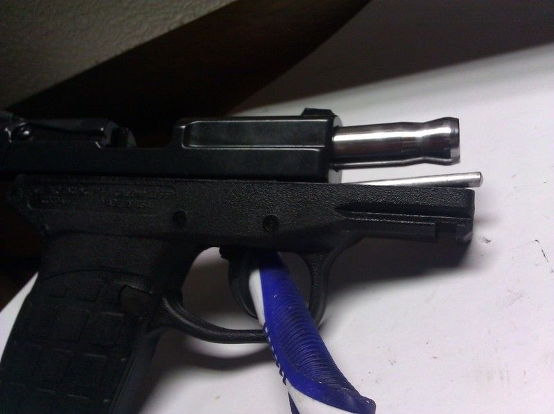

KelTek does sell a metal guide rod as an accessory for $7.45
http://www.keltecweapons.com/product/p1 ... fits-pf-9/
I'm all for home gunsmithing though and I've sure yours is a bit cheaper so long as you don't count labor ;) I love to tinker with my guns.

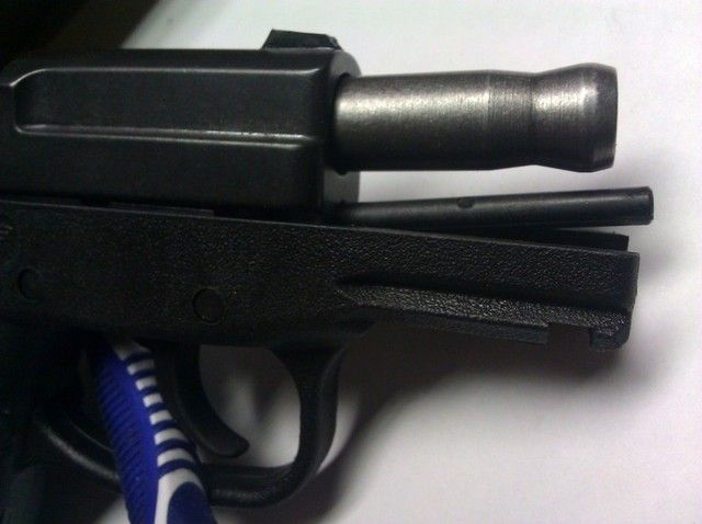

Only warning is that the metal guide rod is known to knock into the bottom of the cone on the end of the barrel and peen it.
It can also wallow out the hole that the guide rod rides in.
(Take a look around on http://www.thektog.org/forum/f95/ , the pictures aren't pretty.)
There really aren't any (or extremely few) reports of the guide rod causing issues.
It's just a "feels flimsy" aesthetic issue where metal rod is a solution in search of a problem.
Your gun, your mileage may vary, you can do whatever you want, etc etc.
Just thought you might like to know. :D

BTW what did you polish the barrel with...loose sandpaper by hand or bench mounted wheel?

When you reshaped the mail head di you alter the part where the sping sits. If not you may have issues the the sprint riding out over the head, if you did you may have strenght issues based on how nail heads are formed.

I used a dremel on the barrel.
So i want to thank you guys for pooping all over my party. Ha. I looked into the issues you pointed out and decided to put the plastic rod back in for now. Feels like i'm being overly cautious for a $200 gun, but it's going to be my carry gun for a little while (until xds comes in 9mm) so better safe than sorry.
I dont think i would have had the same issues as others. My rod was slightly thinner than the stock rod and didnt even touch the frame. Also if you look at my pics the end of my rod doesnt even come close to hitting the end of the barrel.
I am not giving up on this. I am just going to hold off until my life doest rely on this gun.
mmcnx2 wrote:When you reshaped the mail head di you alter the part where the sping sits. If not you may have issues the the sprint riding out over the head, if you did you may have strenght issues based on how nail heads are formed.
I was thinking about this too. I just used a nail that i had laying around. If i were to make a perm rod i would buy a nail that was closer in size and shape to the stock rod.

System7 wrote:Also if you look at my pics the end of my rod doesnt even come close to hitting the end of the barrel.
It's under recoil that it happens, they're pretty snappy and it tends to bounce around enough to hit it.
Keep in mind the spring assembly is pretty well captive once the gun is assembled. If you were careful, you could probably even get it together and functional without any rod at all.
