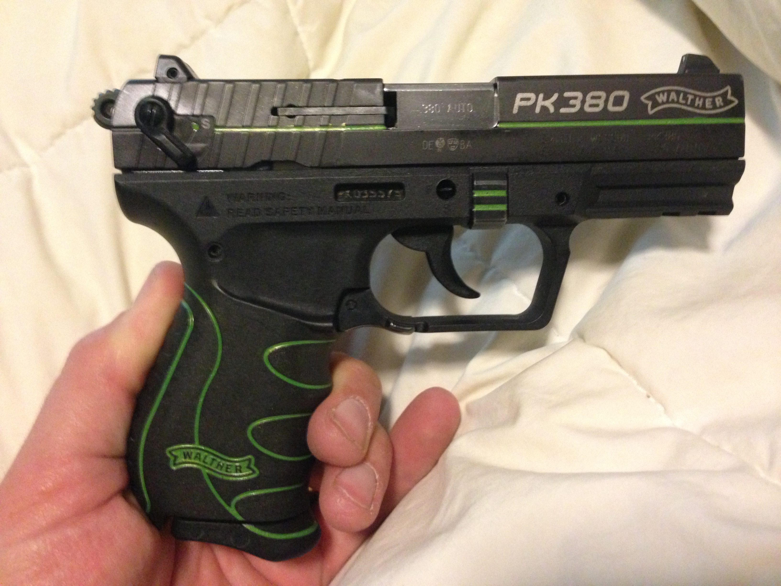

Postby Tommyboyjfd on Sun May 26, 2013 8:54 am
Polished the barrel with Mothers inlaid the lime green. Wife's gun. She wanted it prettier than just black.

Not sure this adjective is supposed to be applicable to a gun :lol: - but it is Cute.
How long did it take to polish?

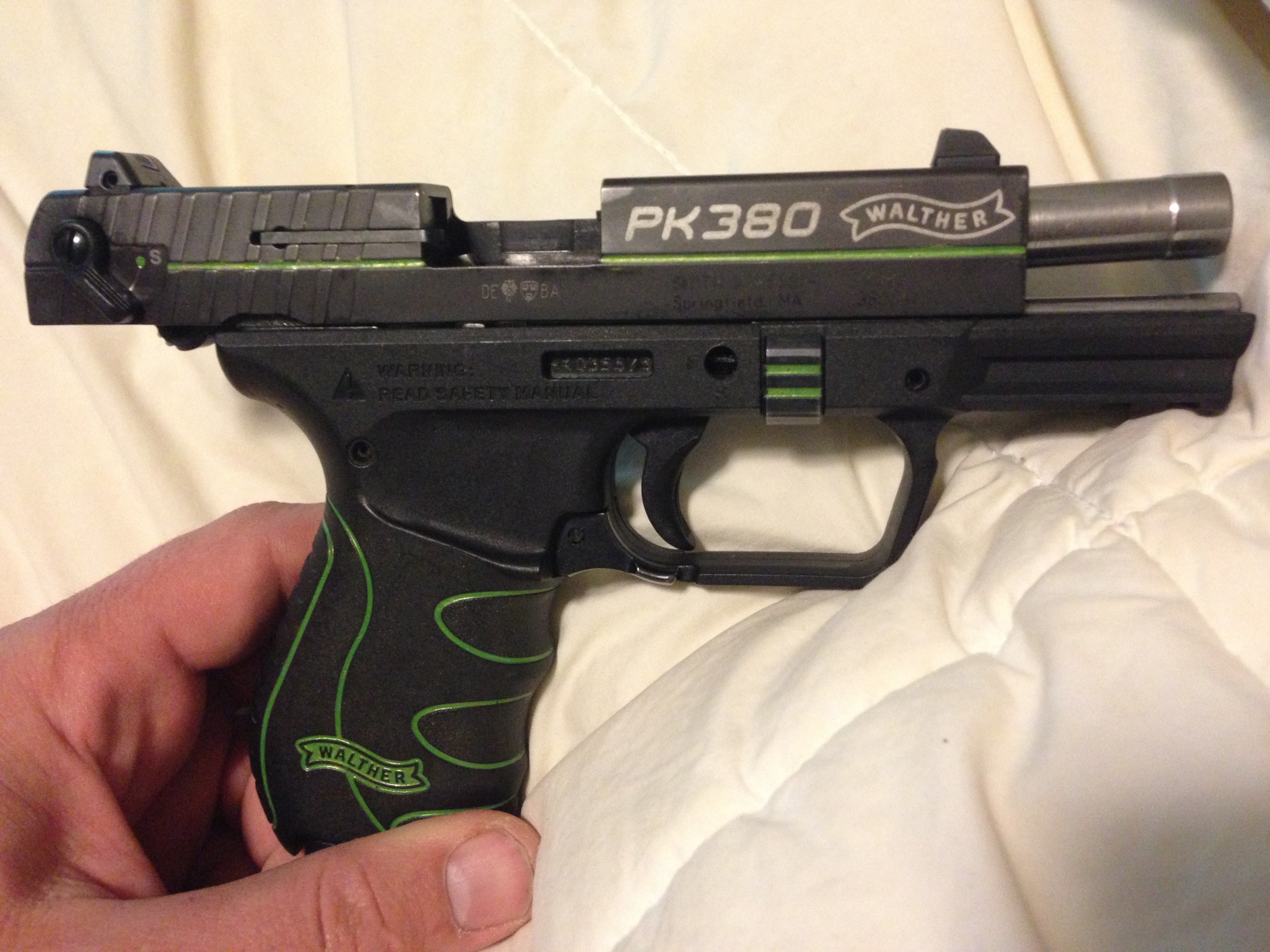

Postby Tommyboyjfd on Sun May 26, 2013 10:04 am
Put earplugs into barrel. Soaked in vinegar for 30min. Scrubbed with a SOS pad rinsed and soaked for another 15 min in vinegar. Then polished by hand and with dremel to a shine.

Postby Squib Joe on Wed Jul 10, 2013 10:11 am
Liquid toilet bowl cleaner removes most bluing instantly ;)

Postby Scratch on Wed Jul 10, 2013 11:25 am
Squib Joe wrote:Liquid Plumber removes most bluing instantly ;)
Good to know, thanks!

Postby DaZhi on Wed Jul 10, 2013 3:34 pm
Any serious downside to not having some sort of protective coating on the metal?

Postby Erud on Wed Jul 10, 2013 5:44 pm
Rust.

Postby Tommyboyjfd on Wed Jul 10, 2013 8:23 pm
Metal polish keeps rust down as does a little gun lube. No issues on my barrel whatsoever.
