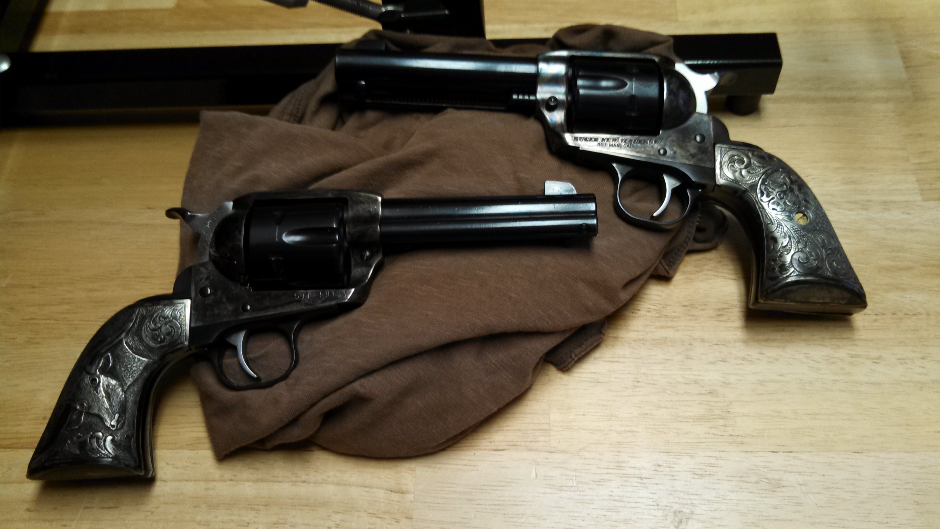

Postby samginko on Sun Jun 30, 2013 2:33 pm
I believe I put super blackhawk hammers on my new vaqueros, I am told it is actually lower than bisley. Here is the pic, easy to cock.
