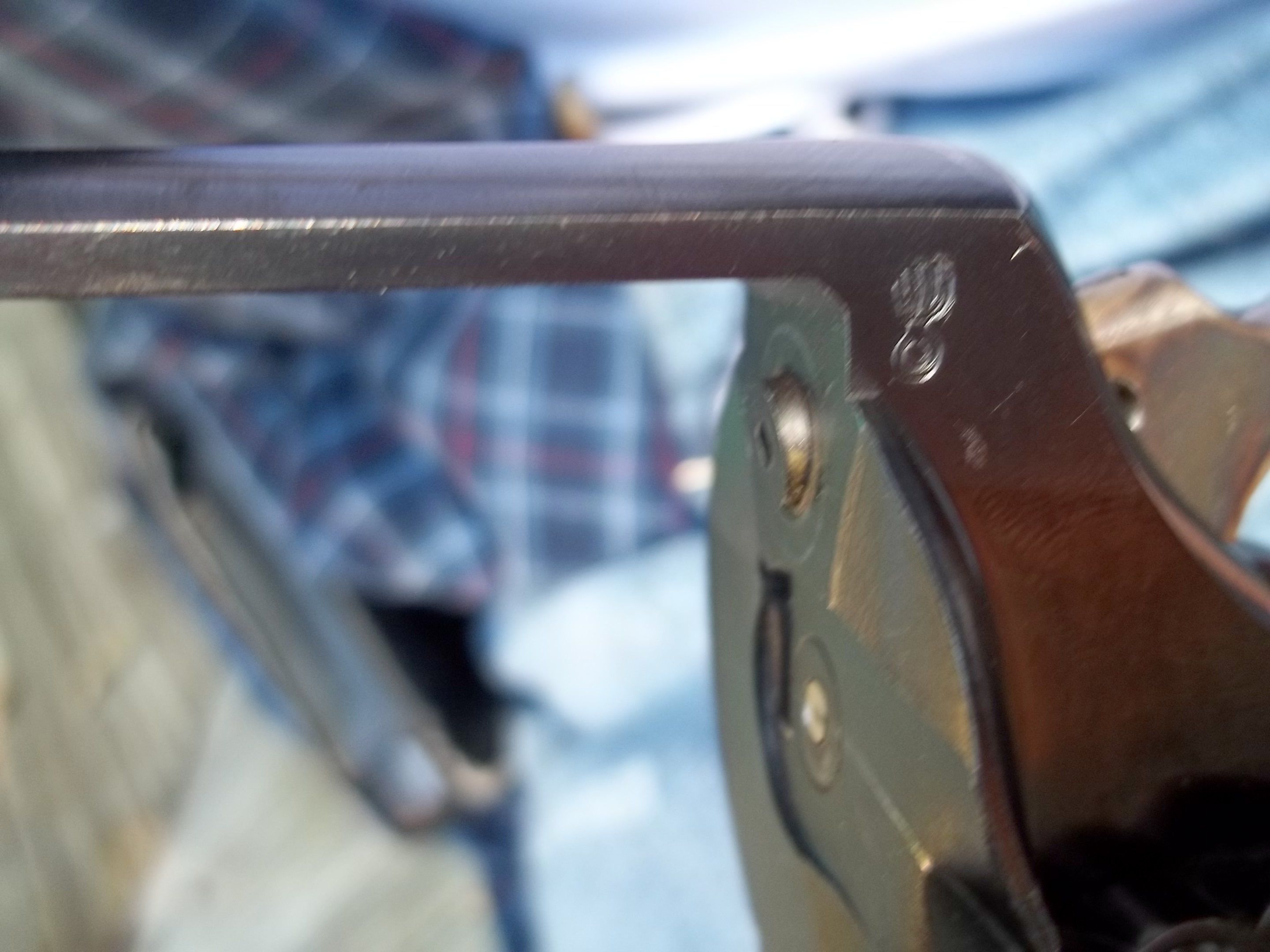

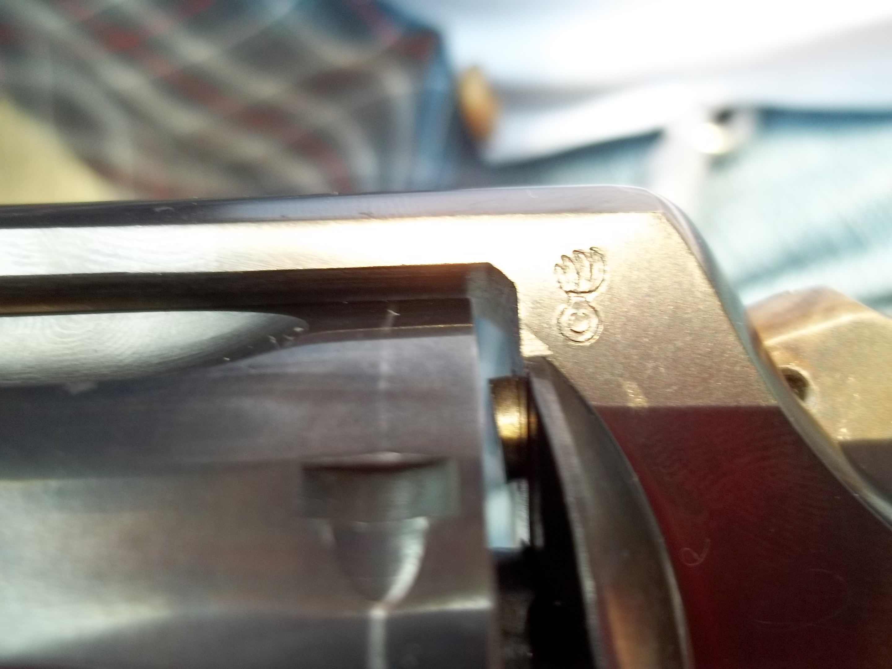

A friend has a SW Model 1917 that he would like help identifying. It has an special firing pin insert that does not allow it to close the cylinder if any rounds are loaded. See photos below. Can anyone help? Thanks.

From the look of the bottom photo, it looks like the cartridge isn't seated all the way in the chamber.

There are no rounds in the cylinder.
The protrusion is the sleeve around the firing pin hole in the frame. Normally that sleeve is flush with the face of the frame allowing room for the moon clip and 45ACP round.

Are you using moon clips?

Postby Rip Van Winkle on Tue Jul 02, 2013 2:51 pm
By golly, look at that.

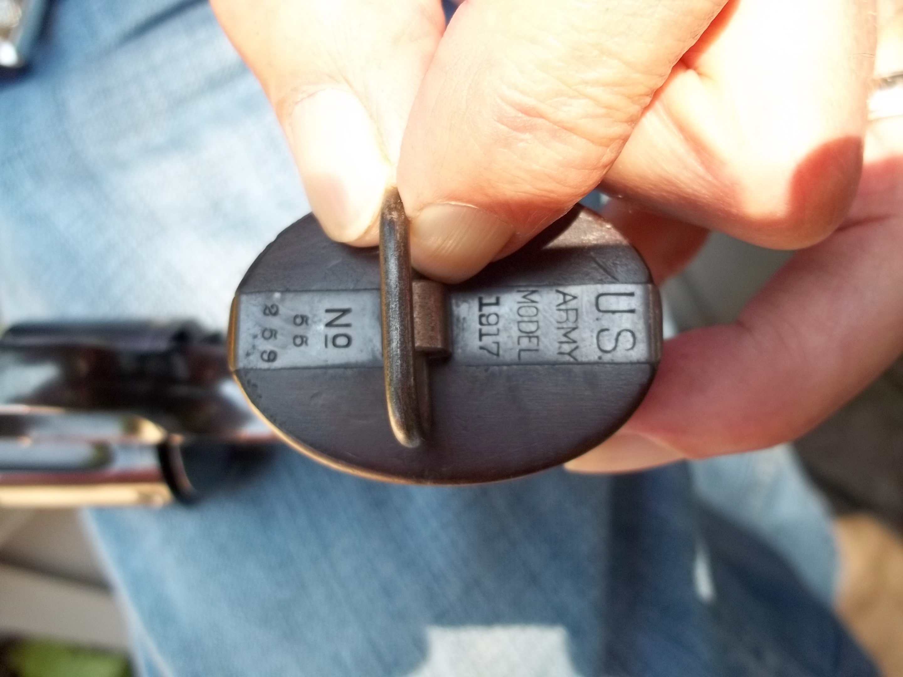

If thats the case, I only see two possibilities. Either someone re-bushed the firing pin hole and after firing or maybe dry firing, the bushing has been driven forward, or a long bushing was purposefully put in it to keep someone from loading it.
ETA: After looking at the third pict I would say the bushing has been beat out of the frame by repeated dry firing.

Postby 870TC on Tue Jul 02, 2013 3:02 pm
Opps, thought that was a round in the cylinder of pic 2. Never seen the the bushing pop out like that before. I would take that to a gunsmith.

Postby centermass40 on Tue Jul 02, 2013 3:10 pm
I agree with Rip Van Winkle ! It needs a new firing pin bushing. It's a $ 5.00 part from Brownells.
