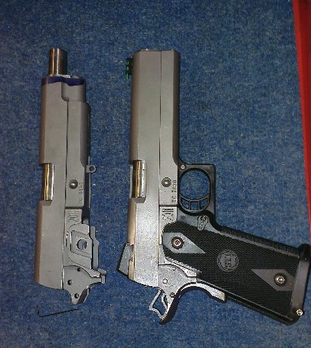

Postby FJ540 on Mon Jul 15, 2013 7:29 pm
High Capacity Carry Option.
Slide showed up at 6pm, it was mated to the frame by 7:50. :mrgreen:
Next stop: Bandsaw! :hide: :goofydance:

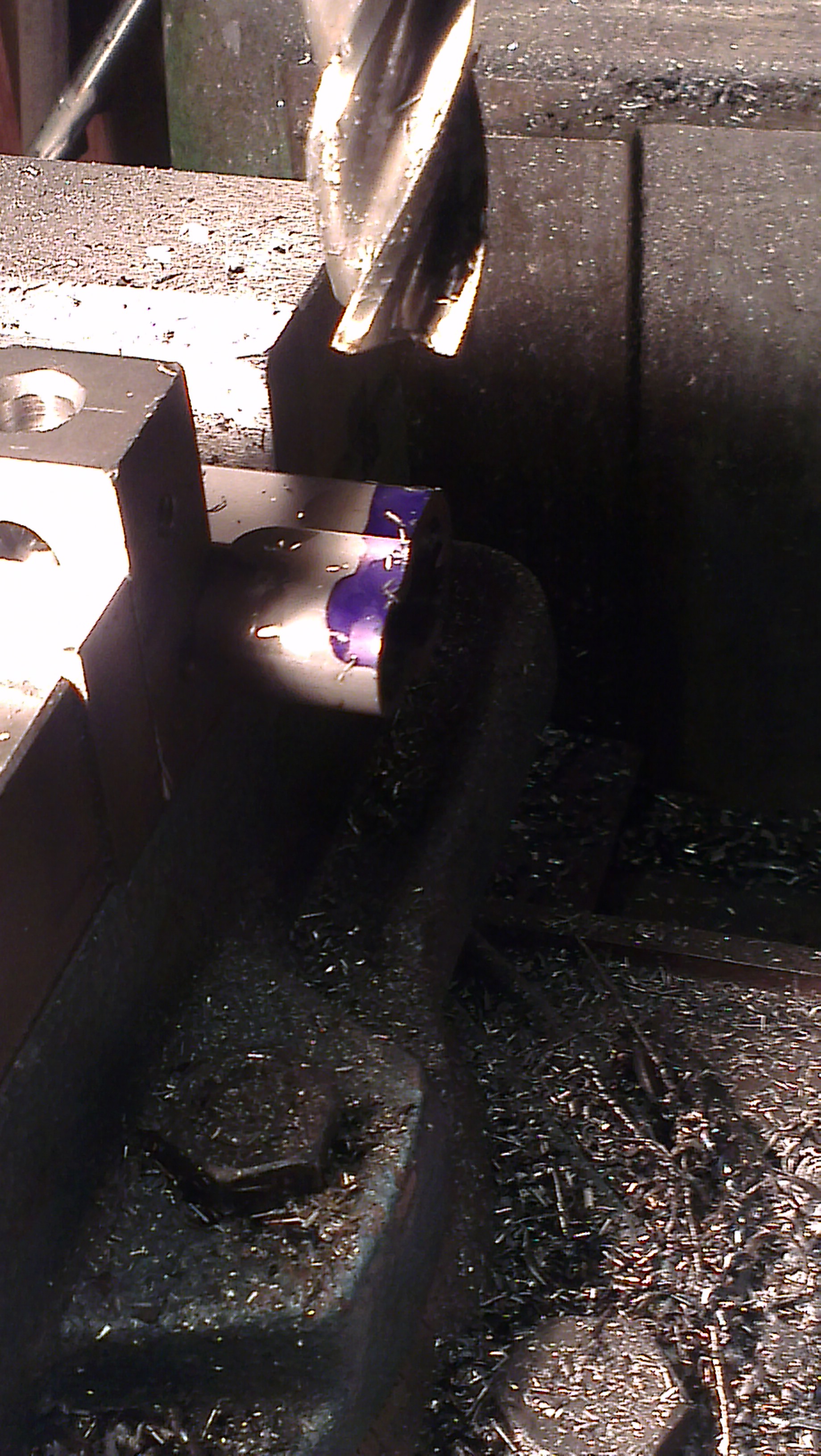

Nope. I shot another 160rds or so through it on Saturday after sighting it in, and still haven't cut the slide serrations. :lol:
Now I'm going to get the frame cut on this one (needs the ramp cutout done), the slide cut down (this will be a 4.25" gun on a 5" recoil system), and if I end up putting sights in it I'll do those too before tilting the head and rotating the vise for slide cuts (it's just easier not retramming the mill until I can get them both done).

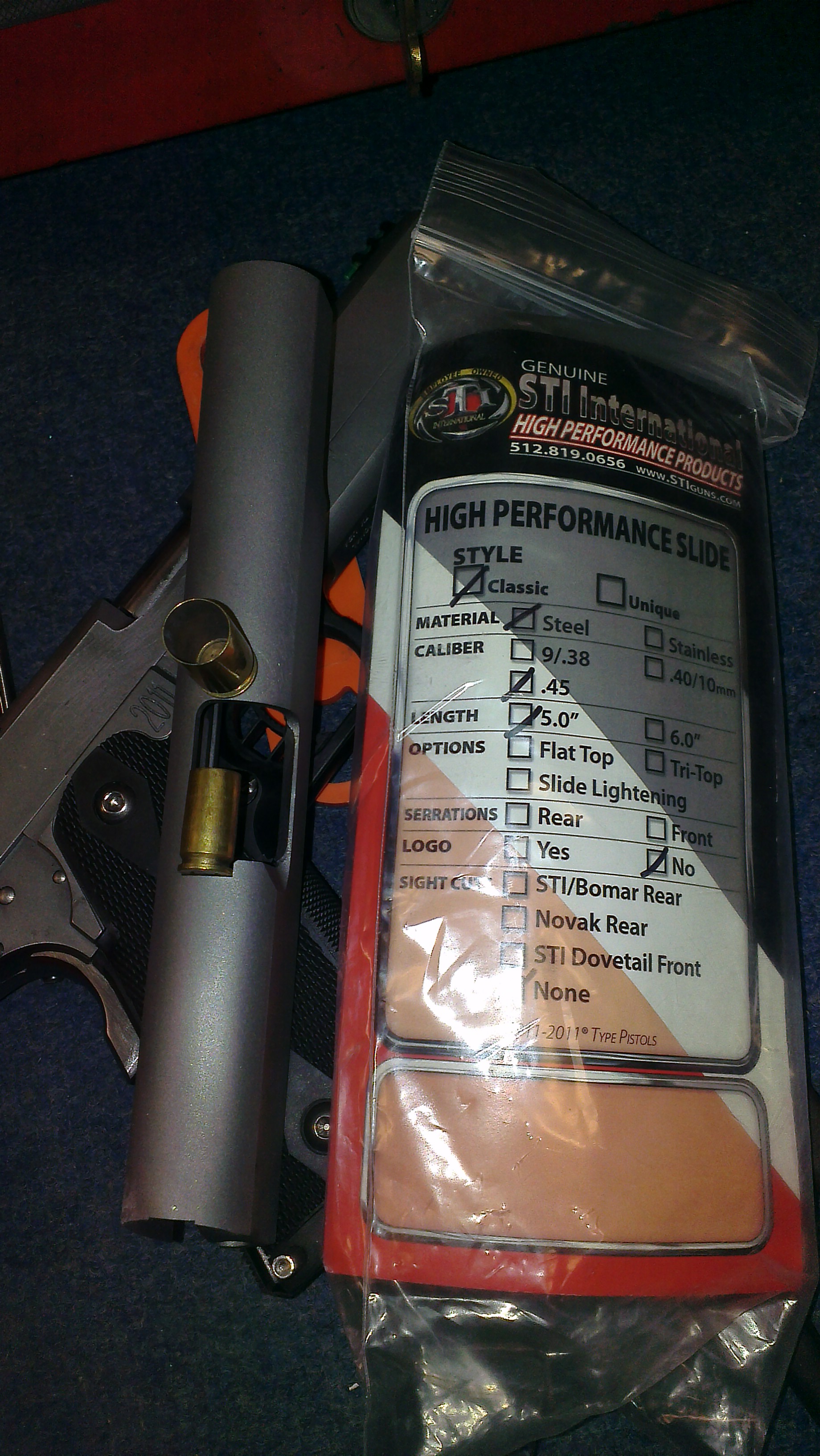

Didn't check the breech face before fitting - they sent me a 9mm slide in a .45 wrapper. :twisted: Email has been sent to Brazo's. We'll see what they come back with.
Edit:
After thinking for a minute, I decided to see how the old slide fit to the new frame (STI runs tight tolerances, right?) and it fits pretty good. I think if they send me a new (correct) slide, I should be able to get it fit up nicely just stoning the bottom.
Pic shows 9mm case held in the breech face, and a .45 on top.
Re: HCCO - AKA: 2nd 2011 build
Postby FJ540 on Tue Jul 16, 2013 1:42 pm
Brazo's said STI'd take care of it and dumped responsibility on them. Guess who's not getting any more money out of me. :roll:
STI says they'll swap it out no problem, and issued a call tag, but won't send me the right one until they get this one back. It's better than Brazo's remedy, but I'd really like to get the new one en route as soon as possible. I was hoping to be test firing this weekend and getting both guns off to plating next week. That probably won't happen now. :(

Postby FJ540 on Fri Jul 19, 2013 11:06 pm
New slide showed up today as promised. Huge kudo's to STI!

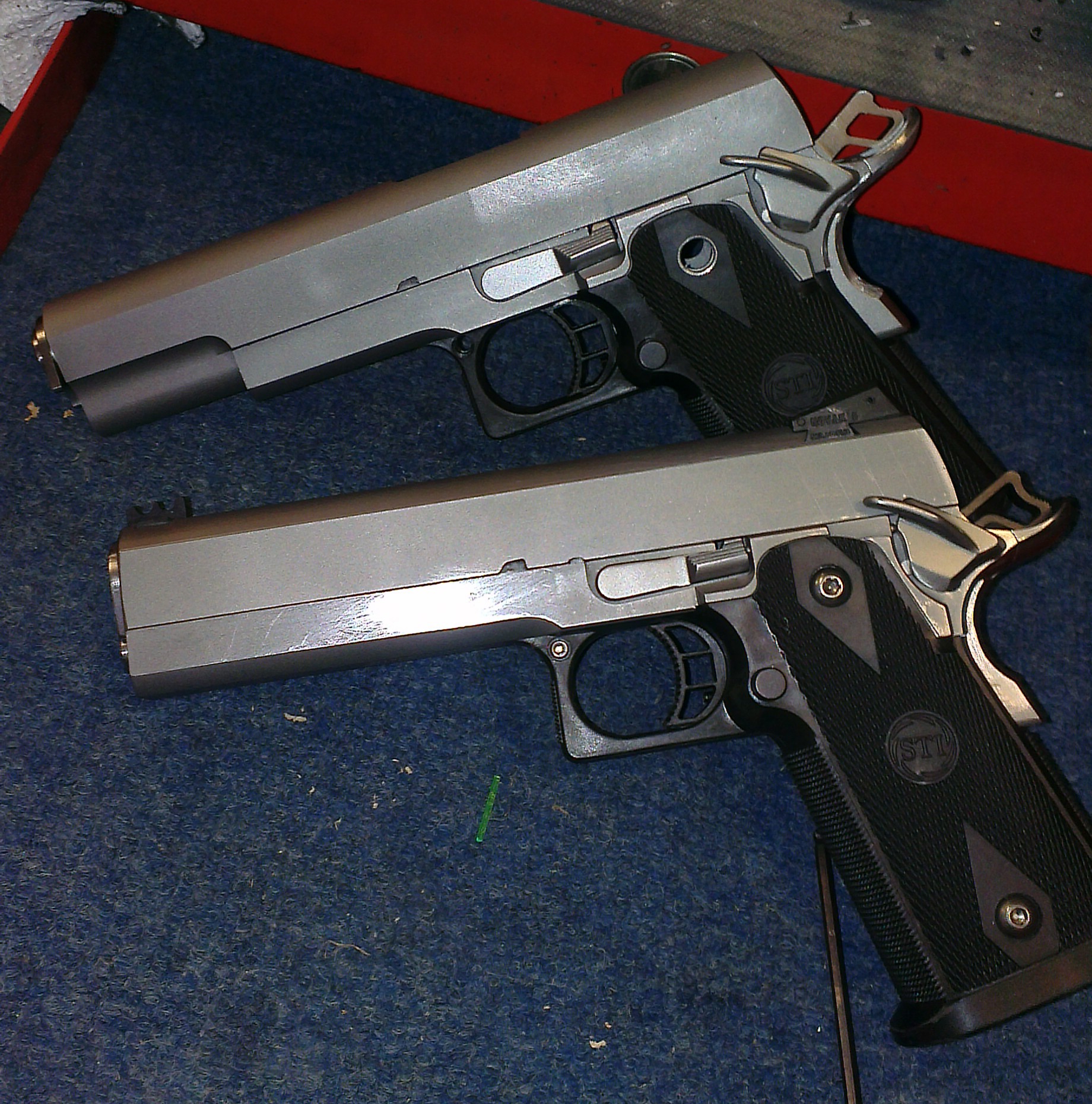

Postby FJ540 on Sat Jul 20, 2013 3:10 am
Still have a bunch more work to do, but it's getting closer to looking like a commander. :mrgreen:

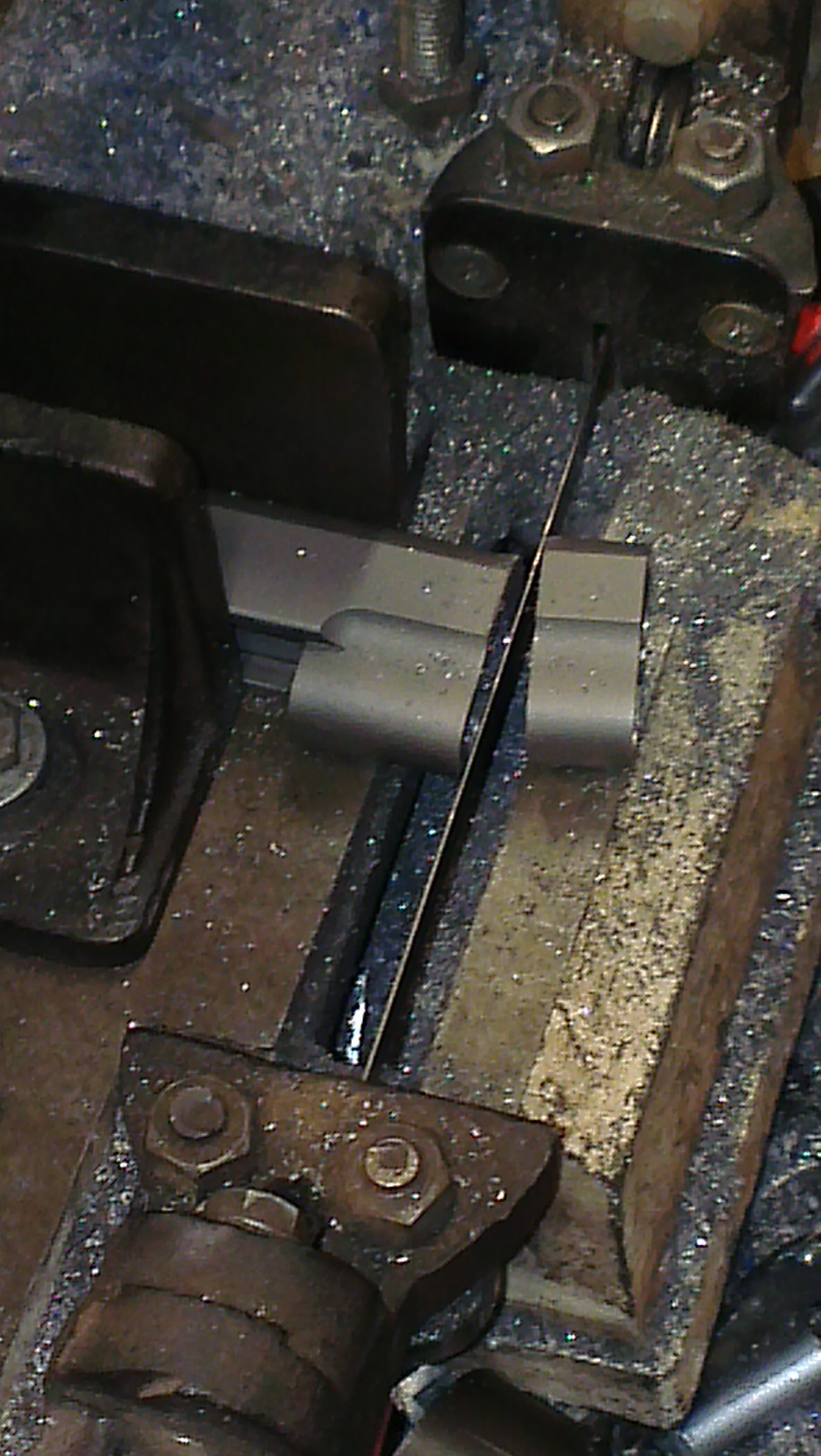

Postby FJ540 on Sun Jul 21, 2013 2:50 am
Got the barrel cut and crowned:
Postby rukwikenuf on Mon Jul 22, 2013 7:29 pm
looks like you'll have a few hours worth of work ahead in rounding edges out. gonna wear out a file!
lookin good man.
Postby FJ540 on Mon Jul 22, 2013 10:45 pm
Actually, this stuff files pretty easily with the fine cut files. It's the coarser ones that slide off it.

Postby FJ540 on Tue Jul 23, 2013 3:12 am
Ready for the range. :mrgreen:
The twins:
As melty as I get:
They both need finish sanding, but that'll have to wait until I get more emery cloth tomorrow.

Postby FJ540 on Tue Jul 23, 2013 12:09 pm
I can get it done in about 10 minutes or less Doug. I'm just pragmatic about it. It's perfect, so I'm leaving it until I have all my other work done. The vise is set to parallel at .002 over 5" (which means it's perpendicular to some fragment of a fraction of a degree) and with the swivel base, that's what's holding me back (it's a pain to get locked in straight). I don't have a swivel for my 688's, only the POS chiwan vise I use on the manual mill.
As for the sights question: I'm not sure yet on this one. :lol: I may put them on, I may not. I'm probably going to flat top it a little either way though.
The reason there's still no serrations on the gamer gun is because I can't settle on a pattern and I started building this one before forcing myself to make a decision. :oops:
