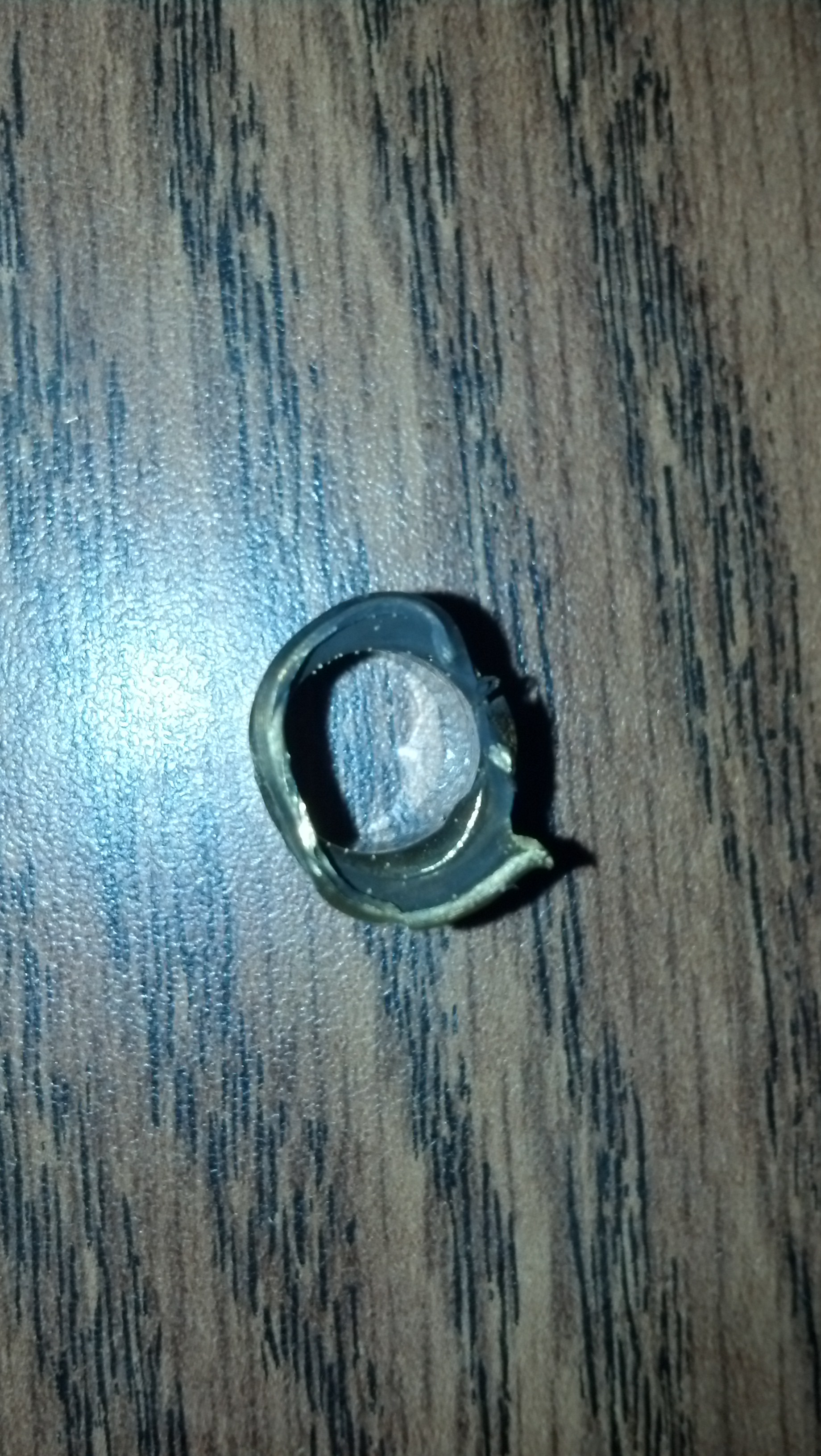

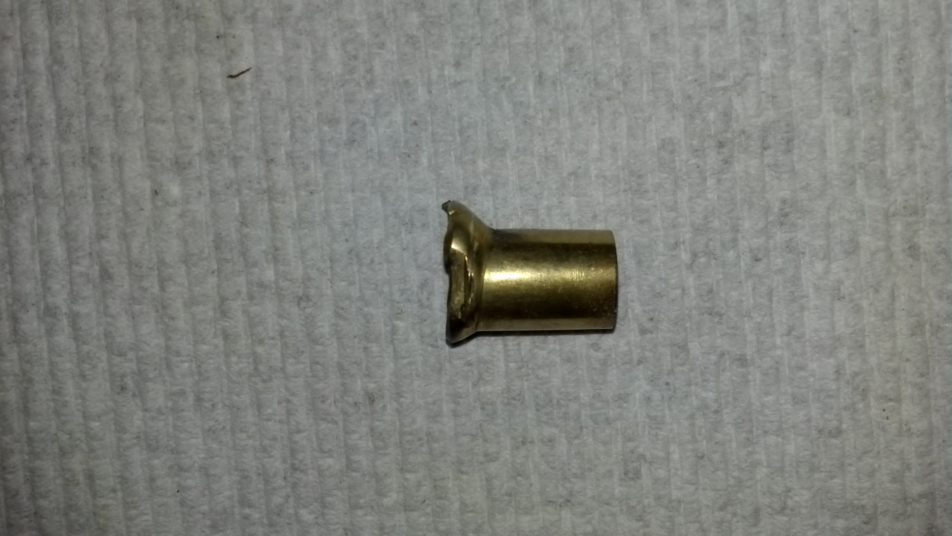

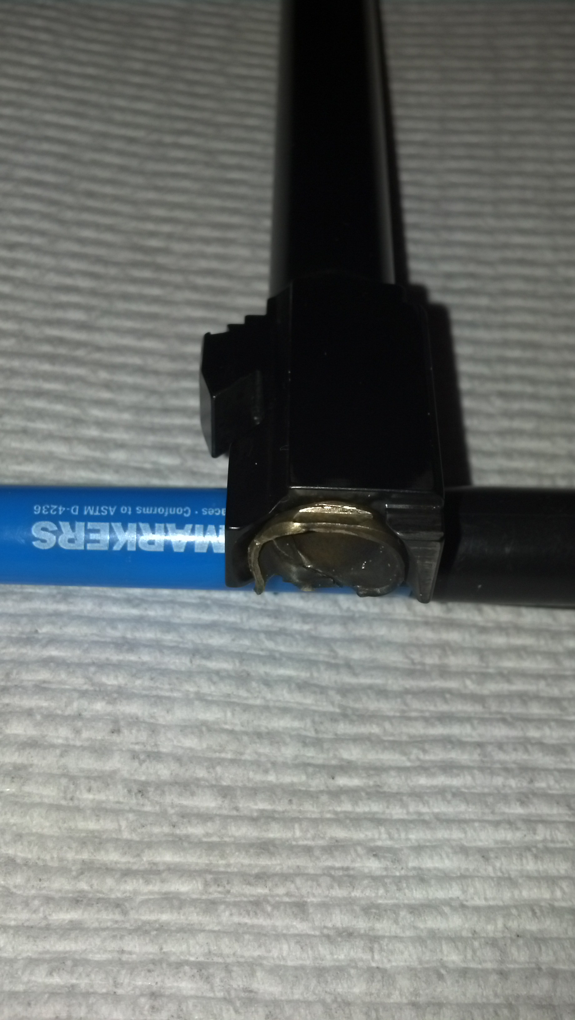

Has anyone seen a shell like this? My plastic frame is now cracked, extractor missing. Ammo condition unknown. Caliber is .40 S&W. :badmood:

The case pictured above looks to have gone boom while only partially in the chamber. Did the round not fully chamber, or did the case rupture as it was exiting the chamber?

Re: Bad KB experience .40 caliber
Postby tabberski on Sun Mar 09, 2014 10:07 am
It looks to me like the shell was not fully chambered. I don't check every time after pulling the trigger on the one before. This is my direction also. The way the case bulged out I think would indicate a not fully chambered round. But I don't work in ammo forensics. Nor am I trying to pass blame, deflect or assume cause of the situation. Firearm was brand new to me, but used. Appeared to be in very low round count. I have a few shells left and will measure and pull apart to measure volume. Barrel appears fine. Only harm done was to the wallet.

Postby OldmanFCSA on Sun Mar 09, 2014 10:21 am
Measure just ahead of the case head, where a bulge is likely to occur. This is what I found to be the problem with my first loaded 40S&W ammo. The bulged case would not fully seat into the chamber properly, maybe this was the cause of your accident.

Now that I'm not really pissed anymore I looked into what caused the problem. One thing of interest I found was that the thin long pin and spring were not in my slide. I don't know if they would have gone shooting out during the event. So extractor gone, pin assembly gone.

Postby Seismic Sam on Mon May 19, 2014 1:49 pm
I agree - looks like you got a 40 case with a pretty bad bulge, the size die took all of it out except the back end, which then failed to chamber all the way but STILL allowed the gun to fire.
Question: Do Glocks have disconnects like 1911's so the hammer won't fall unless the slide is fully in battery?
I use the Redding G-Rx debulger for my 40, 10mm and 357 Sig brass. For 10mm and 357 Sig with full power loads, the bulge is a lot lower and can actually include the case rim. Not nearly as much with the 40, which bulges higher up (in some cases nearly half the case length! :( :o :shock: ) I have also tried the Lee die to debulge the brass, and the smoothness of the carbide with the Lee dies is not nearly as good, meaning it takes a LOT more effort to shove the case through the die. In addition, I think the Lee dies are just tungsten carbide, while the Redding dies are Titanium carbide, and there's quite a difference in friction between the two.
If this had been the other 40 problem with a Glock, which is bullet setback, the resulting pressure spike normally blows the slide off the rails, literally.
