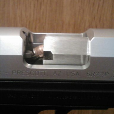

I'm having problems with two Ruger SR22 pistols.
Pistol 1) Maybe 50/50 if the extractor will grab and extract a live round (always extracts spent cases). A few rounds (out of a couple hundred) were a misfeed where the bullet would kinda get jammed into the chamber sideways and the slide would crush the case .
Pistol 2) Same misfeed problem as above but a ton more of them, maybe 15% were misfeeds (again out of many magazines worth, at least a couple hundred rounds).
I'm thinking a bad magazine may have been causing the misfeeds. One magazine was a little tight so you actually had to barely push the rounds in, the other magazines you could drop the rounds in (when holding the follower down).
I just got off the phone with Ruger, they're claiming that it's normal for a firearm to not be able to extract a live round from the chamber. I asked "How are you supposed to make the gun safe during a ceasefire?" and they didn't really have an answer for me. I can actually see that the extractor on both guns kinda disengages from the rim in the last millimeter or two of travel when the slide is closing.
I've already decided I'm sending the magazine in for replacement. I haven't decided if I should send one or both guns in as well to be checked over. I did find mention of fixing the extractor on another forum by filing a couple thousandths off the extractor or the extractor notch in the barrel (I would have to research a little to make sure I filed the correct item by the correct amount).

I took them both out to the range again today and tried to isolate which (if any specific) magazine may be causing the problem. First magazine with pistol #2 had the same stoppage (Blazer High Velocity). I marked that magazine with a piece of tape, then the gun proceeded to run flawlessly with 2-5 magazines of each of the following: Remington Subsonic, Remington High Velocity, Blazer High Velocity, Norma Tac-22 Standard Velocity, CCI Stinger Hyper Velocity.
Pistol #1 ran about 80-100 rounds flawlessly, then experienced a stoppage with the non-marked magazine and CCI Stingers... crap, there goes my bad magazine idea and any chance that it was from a bad batch of ammo. I ran another 250-300 rounds through it using the above mentioned mix of ammo, and I re-introduced the slightly-too-tight magazine into the mix...couldn't get another stoppage.
